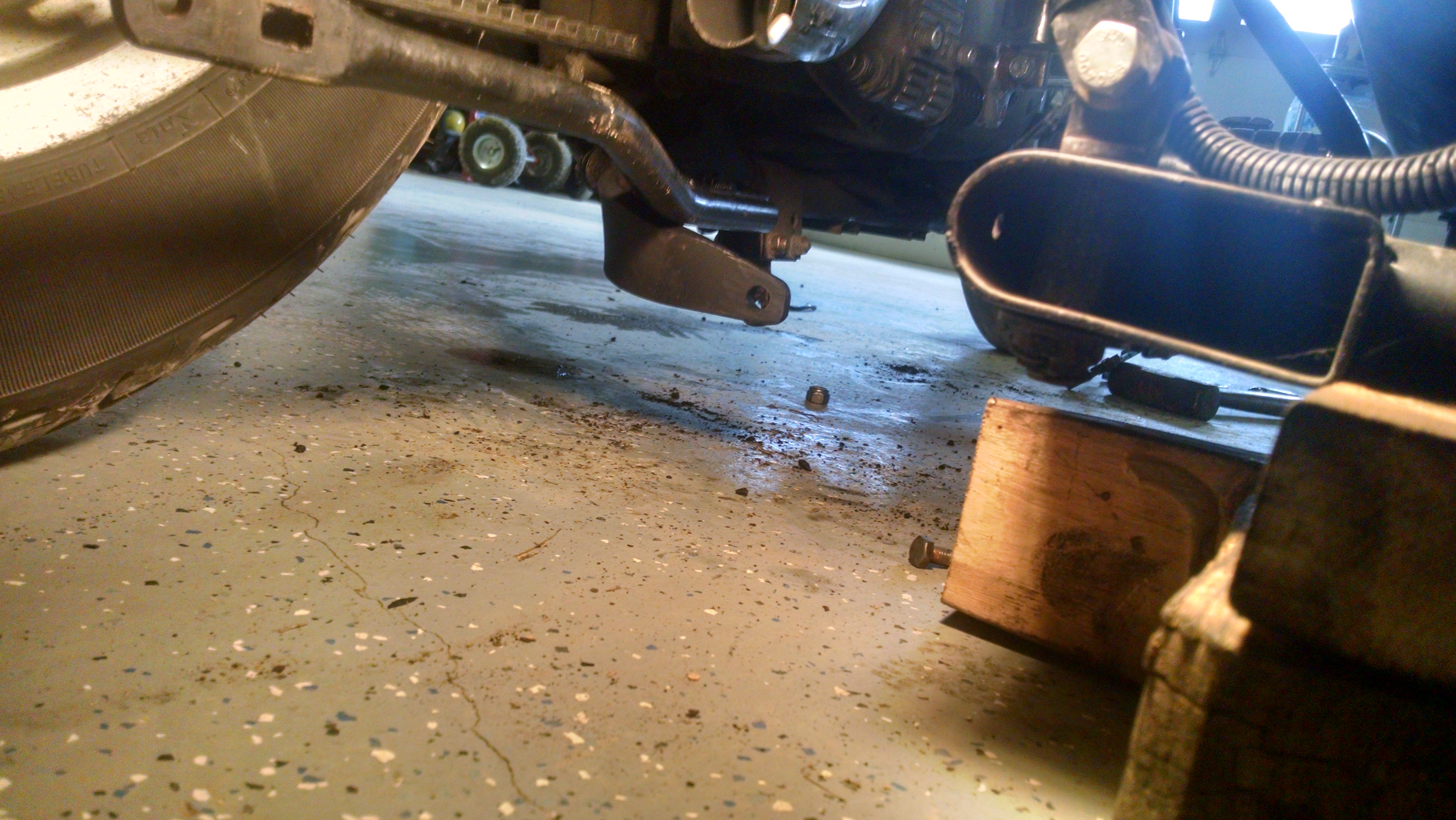

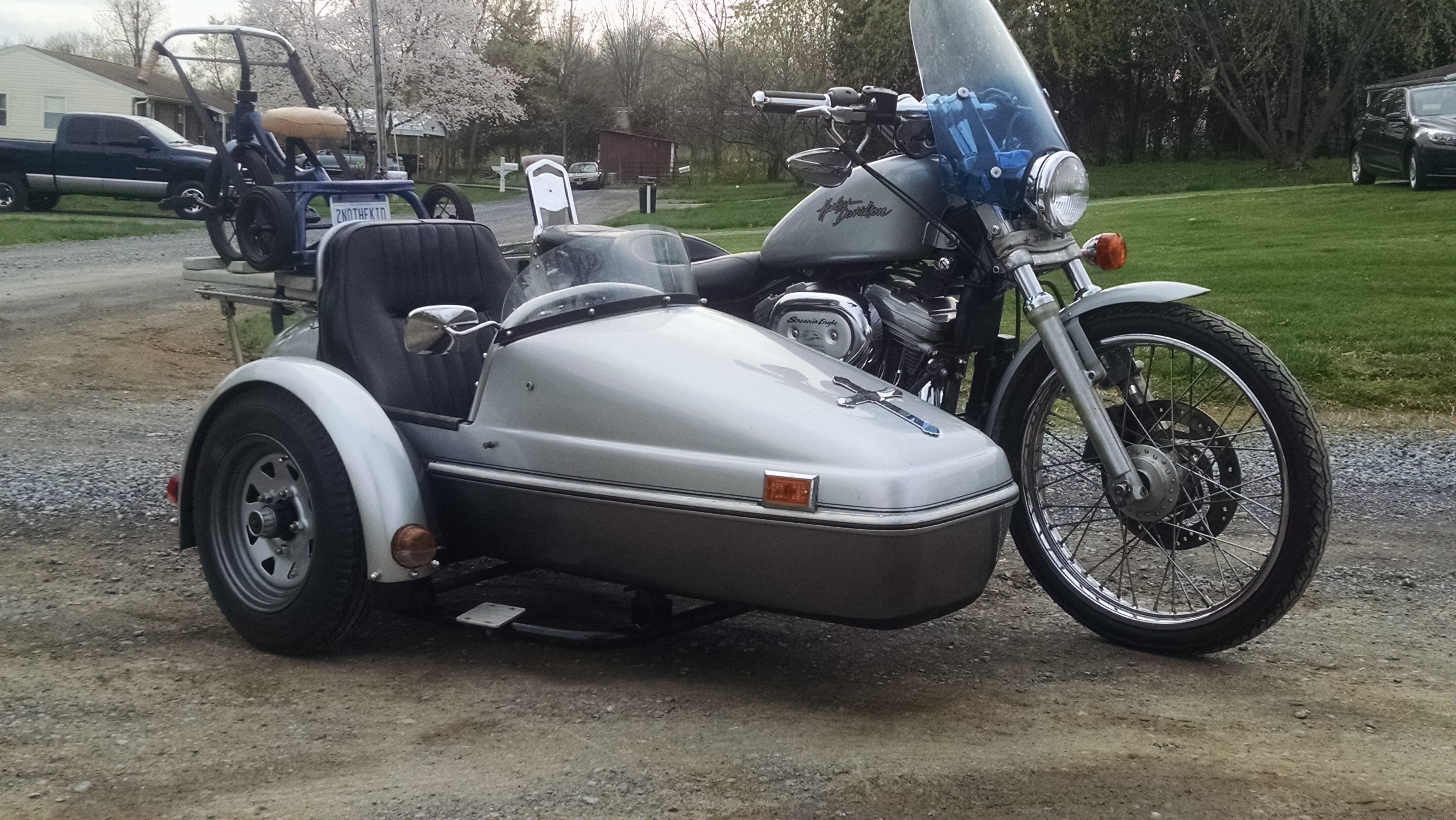

Bike lowered and sidecar wheel in mockup position. Welding to be done this week
Posted : March 14, 2015 12:07 pm

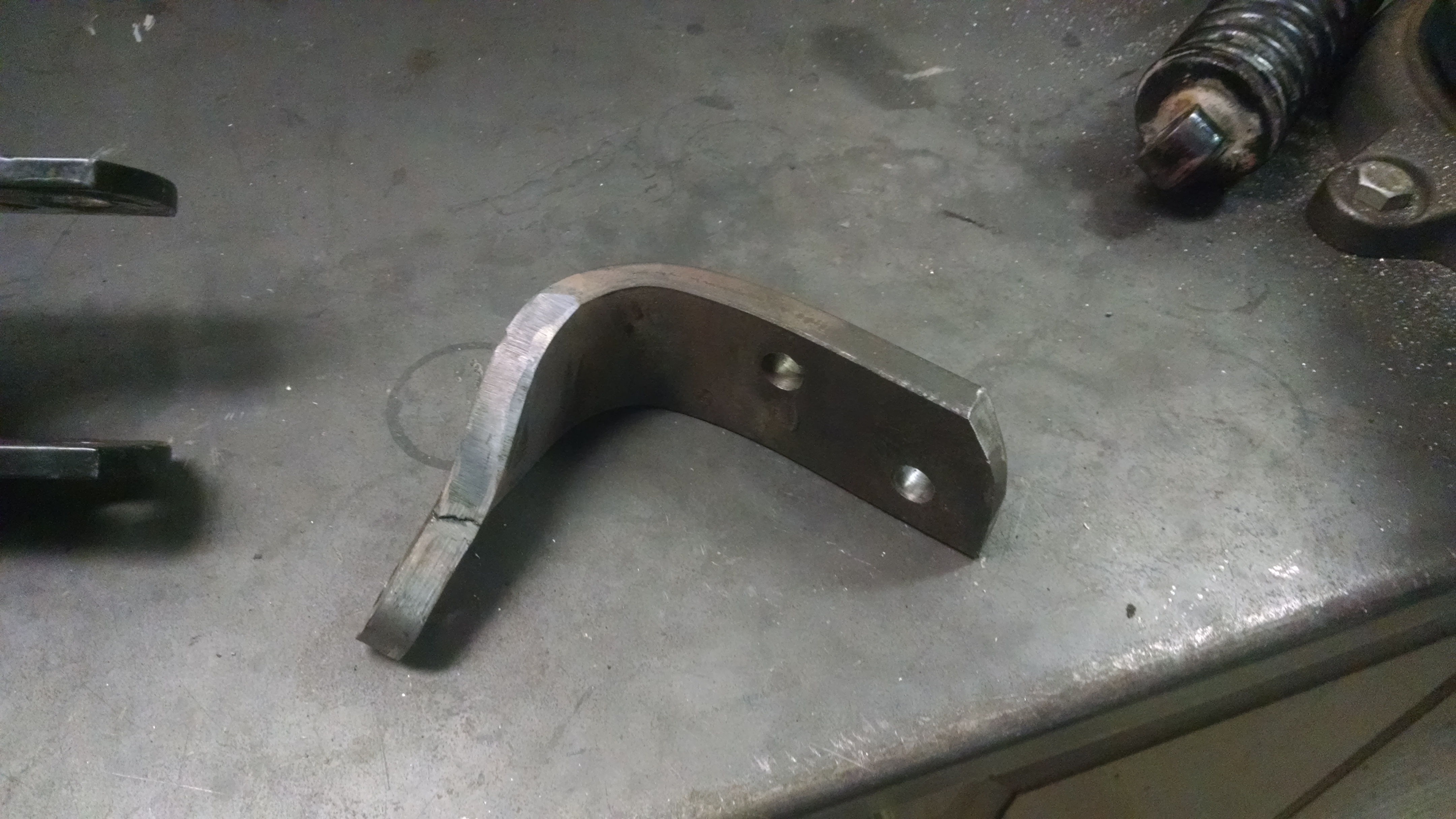

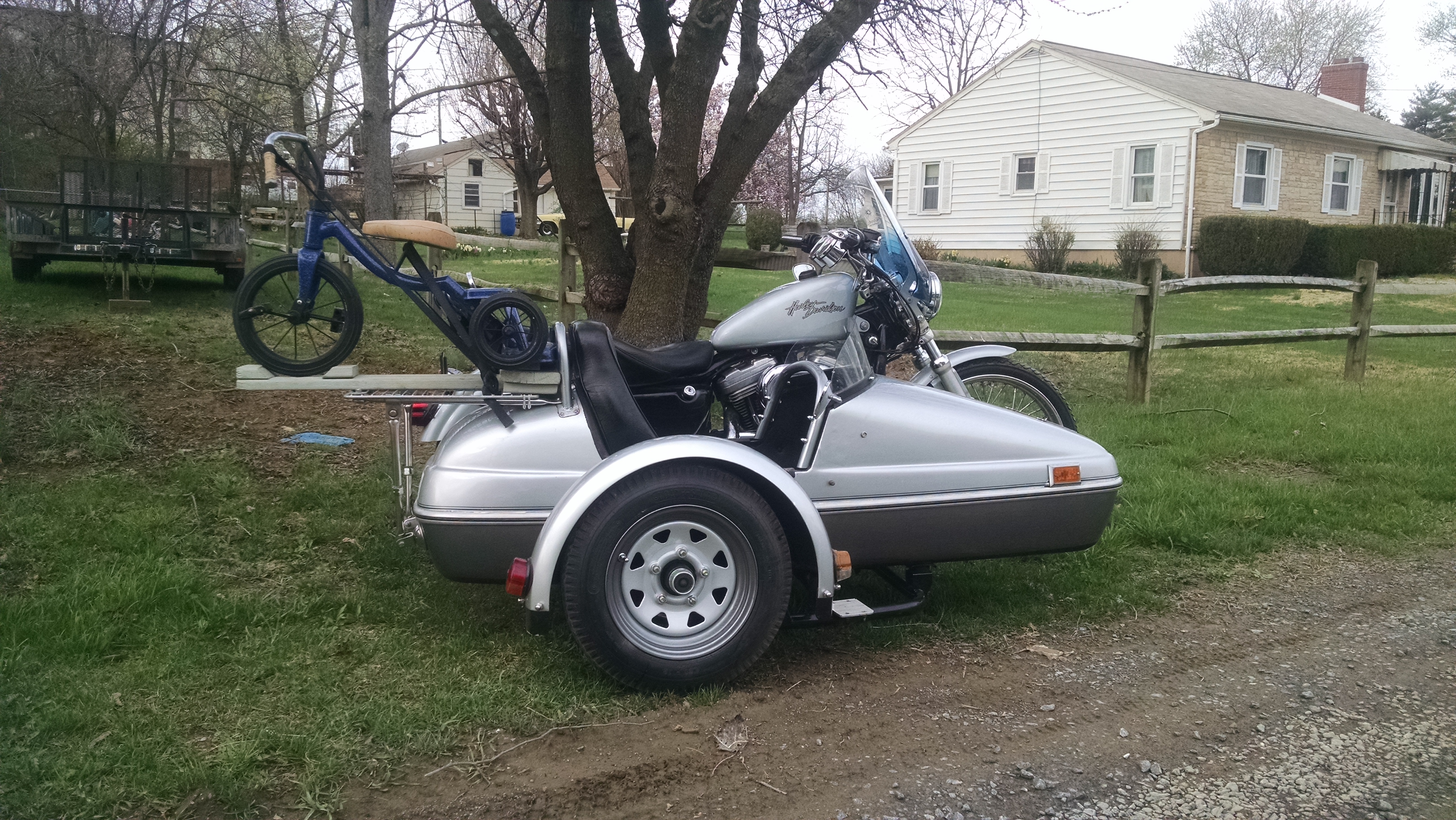

Rear lower mount is 3/8" x 1 1/4" bar stock bent and drilled
Posted : March 31, 2015 11:12 am

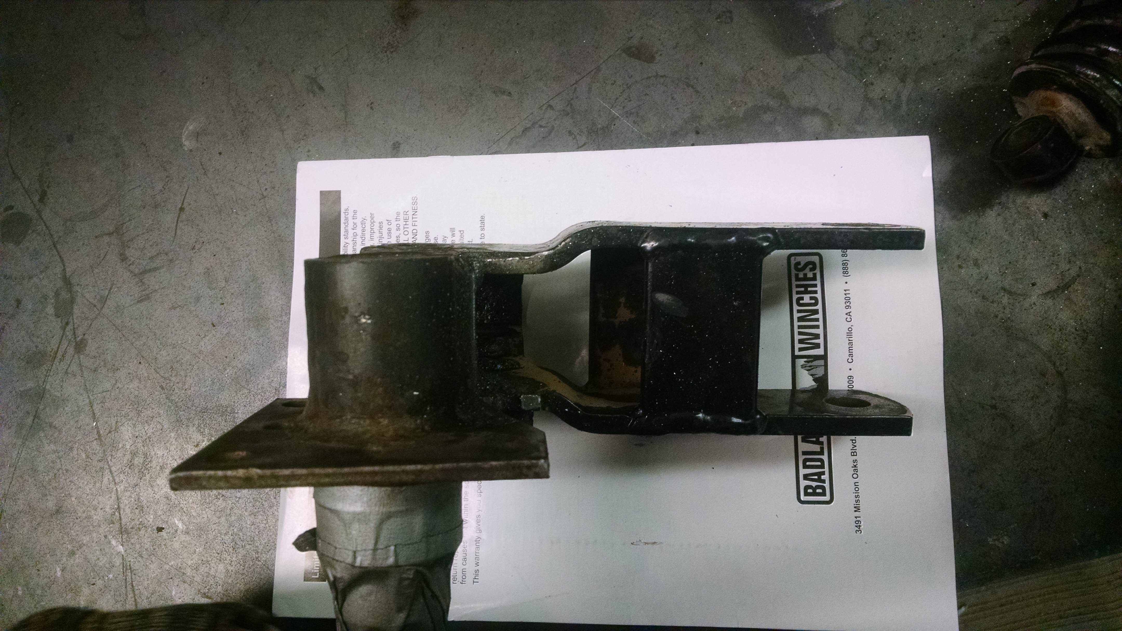

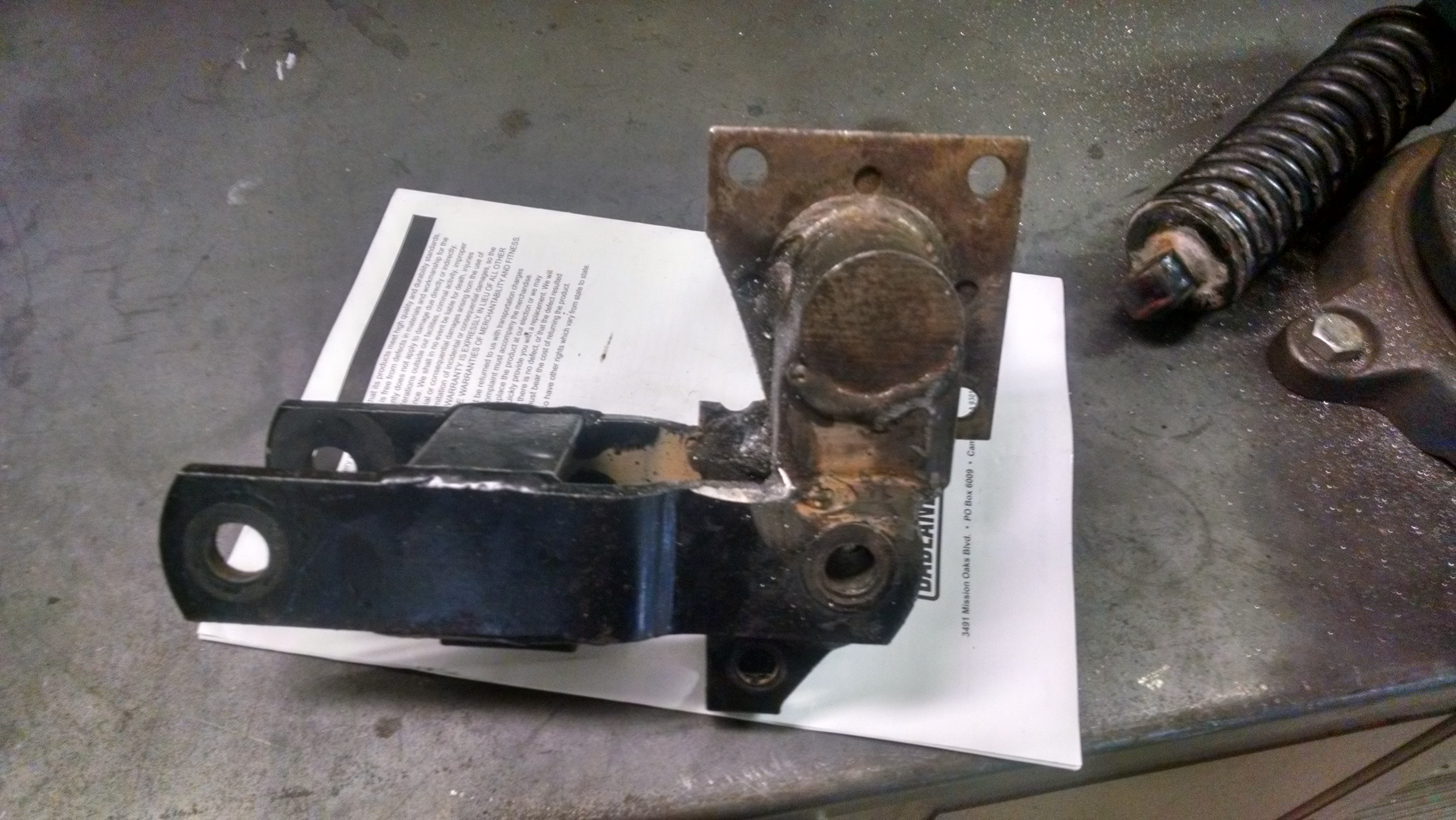

Hub welded to the old swing arm
Posted : March 31, 2015 11:17 am

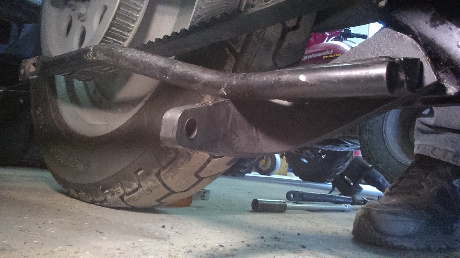

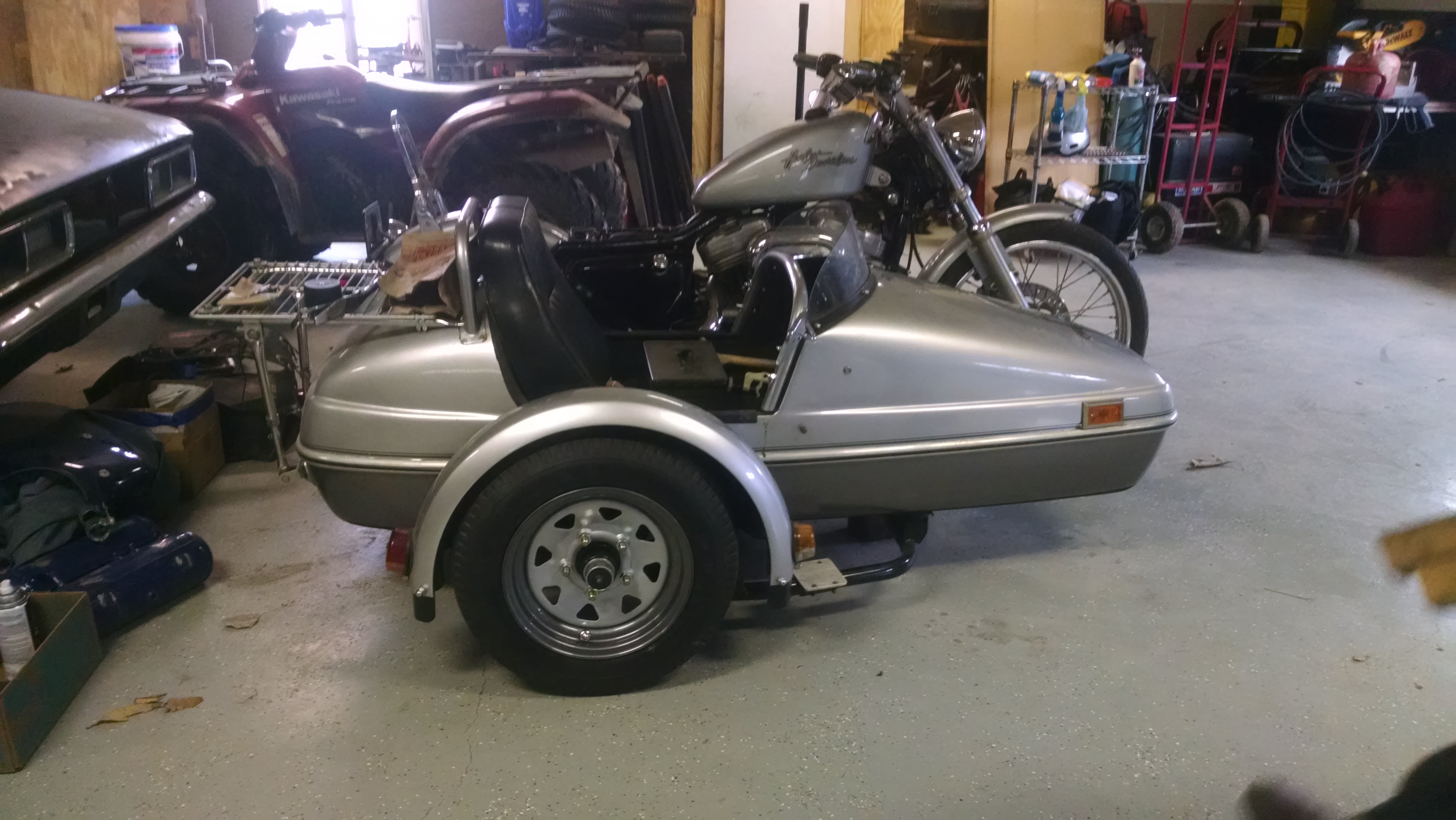

A picture out of the garage.
Posted : April 20, 2015 4:18 am

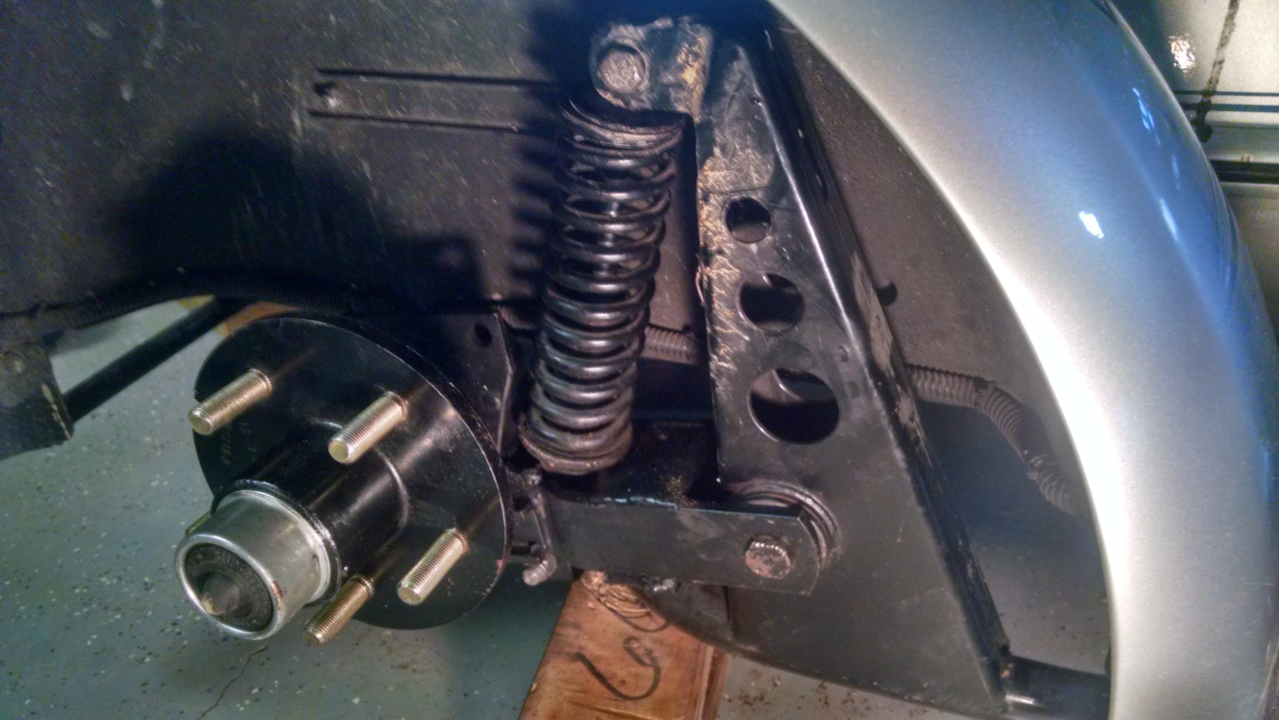

Ok here is some more details. Bike is lowered 2 1/2" sidecar is lowered about 4" and the overall rig is 3" wider with wheel lead reduced by about 3".
So since riding from April 12th till now I have noticed a few things. The sidecar feels heavier , the steering feels lighter and i reduced the counter weight by 25 lbs..
I also put slightly quieter mufflers on and it seems to have increassed power slightly, I have found myslef a few times running 80 MPH on the interstate.
