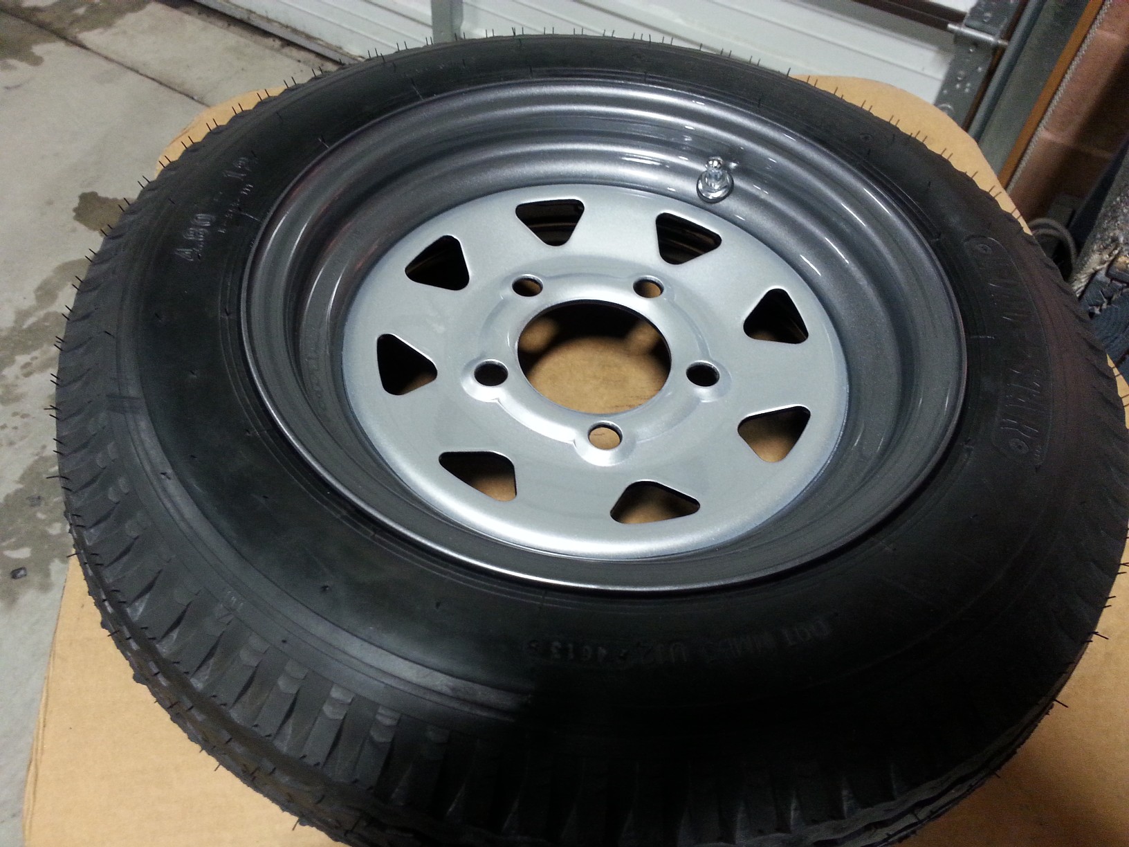

Got the new wheel painted 2 tone to match the bike and got the tire back on today......
