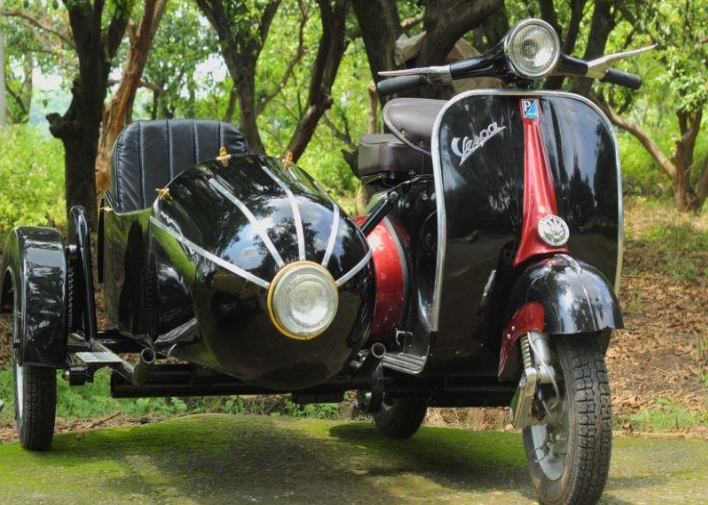

So I have this 250cc scooter and I was thinking about throwing a small sidecar on it. I am looking (online) at Inder and Cozy. The Inders are cheaper in price. Has anybody here actually seen one, ridden with one, etc. Can you tell me anything about quality?
FYI the picture is from the Inder website

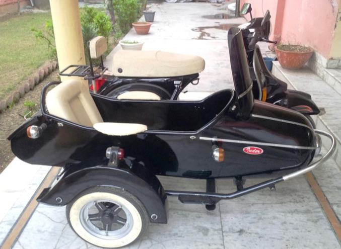

Thanks NC Dave and Al. Good advice. Actually, I don't plan on putting anyone in it other than maybe my dog....and groceries 🙂 I just got a spec sheet from Inder on the new models. Lets see if it will let me upload it here.
Yup. Take a look at these and tell me what you think
BEEMER@SPEC.pdf (860.8 KB)  EURO@SPECIFICATION copy.pdf (1.1 MB)  ROCKET@SPECIFICATION copy.pdf (1.5 MB)

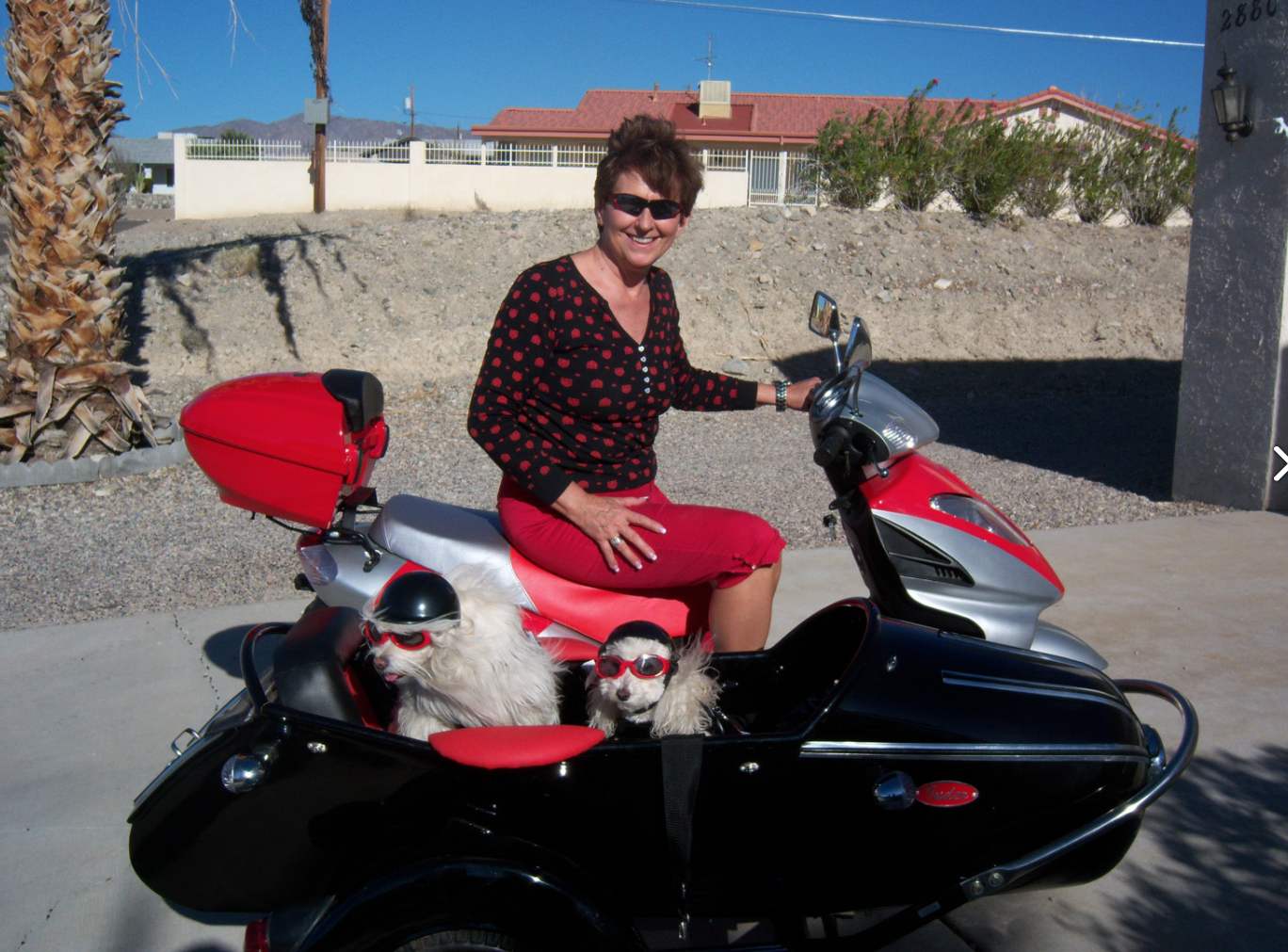

A couple of scooter/Rocket rigs
Posted : March 7, 2017 11:36 am
those are a bit different frame design than the one I have. mine has a 90 degree bend around the front where these have a tube straight across. I can see where that design would work better for attaching the er though. car designs are different too. I tried to find my old links from research and purchase, but can't find them.
