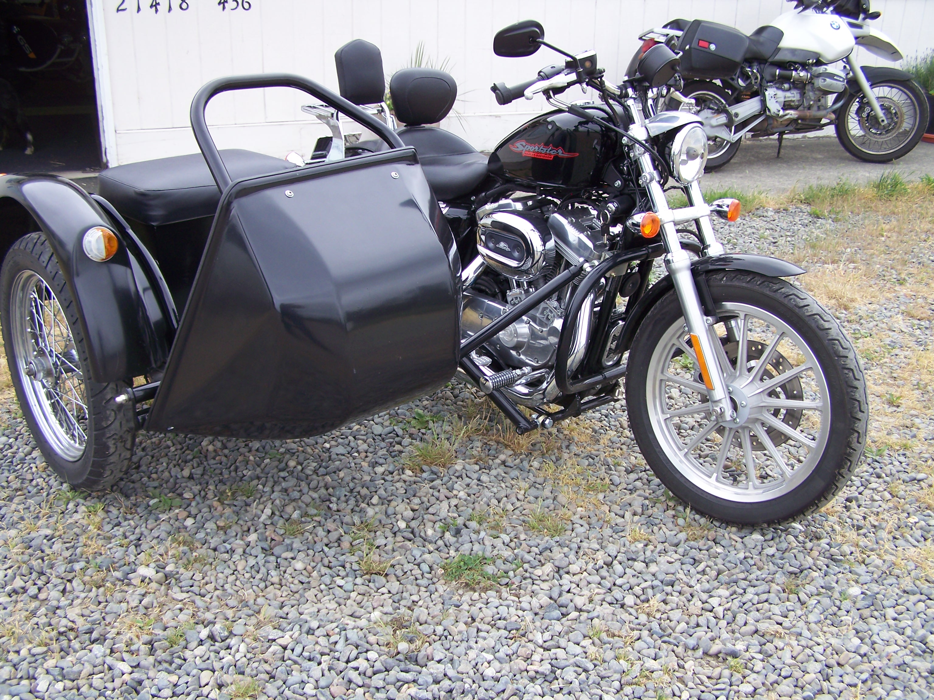

(@wvsporty)
Posts: 411
I have an 883 Sportster with a Velorex, when it was standard ride height I had no problems on back roads , crowned one lane dirt roads and bad driveways. I have had it together for 4 years now and love it. Last winter I lowered the sidecar 4.6" and the bike 2.5" and i have to be careful on a lot of the back roads and on the fourlane roads with stop lights. The heavy trucks crush the asphault and create high spots in the middle of the lanes and at the divider lines. See pictures below( as soon as I get the computer to cooperate)
