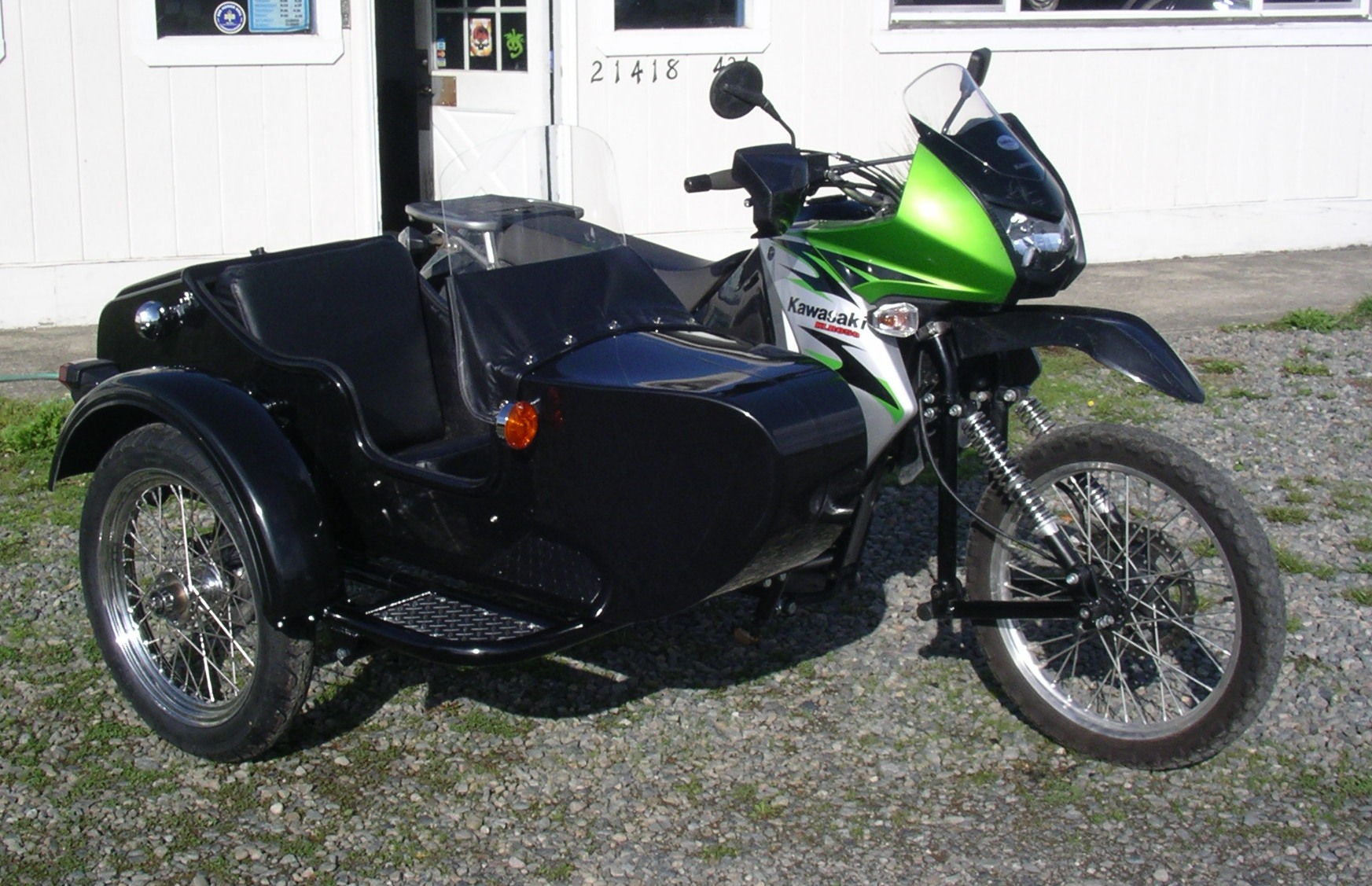

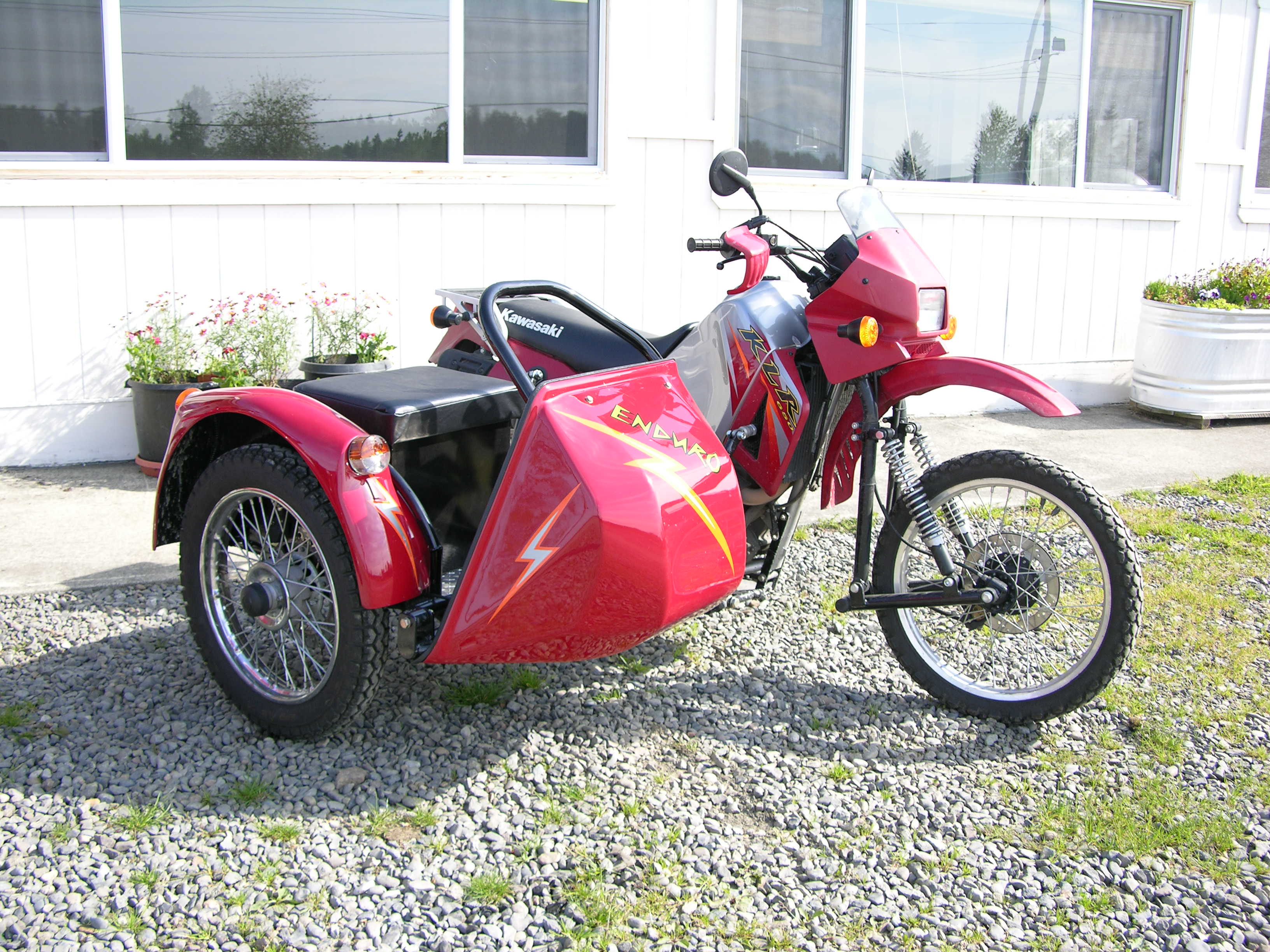

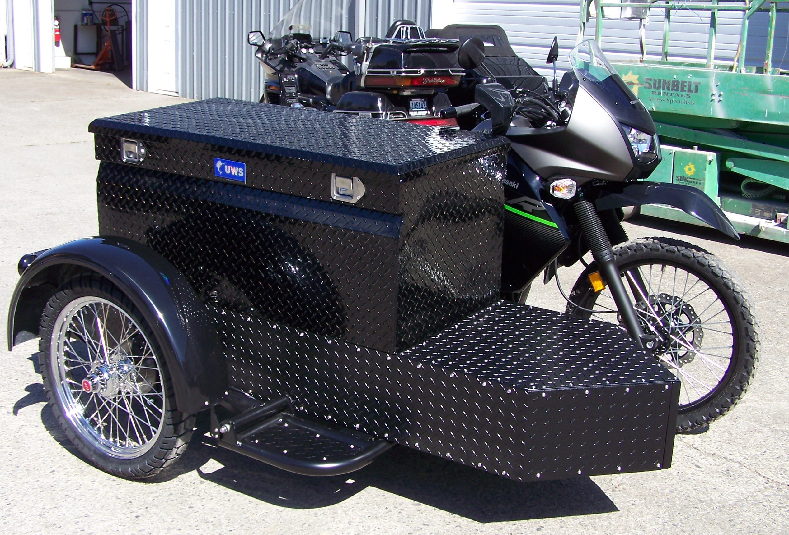

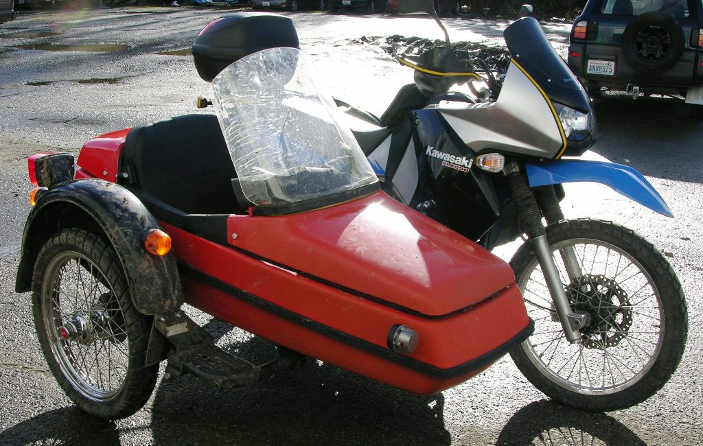

We have done many KLR sidecars and offer 100% bolt on bike specific mounts that work on all years of KLR's and have built many KLR sidecar bikes, I own and ride one my self. Right now the best bang for your buck is the Russian Sputnik we have which is what I have on my own KLR and can be seen at this page http://www.dmcsidecars.com/sidecars/sputnik-sidecars/ $3295 hardware included. We also make the Enduro, M72B, M72D and Cargo sidecars that work well on the KLR. The KLR's rear spring is a bit week for sidecar use, we offer a spring for $85. As it takes as special spring compressor to install we have you ship us your shock and we swap the spring, We do not charge for doing this. You will loose any skid pan you may now have on your bike. If you want a skid pan that works with our mounts they run $75. I strongly recommend a brake on the sidecar $650 for any of our sidecars. Some people tell you that you do not need a brake which is why we make it an option. Several years ago we were filming for a video and still photo's for the book "driving a sidecar outfit" (also known as the yellow books, we stock it for $34.95) as we were rushing to build a bike and sidecar for the day that the photo shoot was to happen and did not finish the bike until late the night before we did not have time to get the brake built so we were riding with out a brake. Coming down a step grass and wet leaf covered hill with the sidecar trying to push the front of the bike to the left I had to chose do I want to use the limited traction on the front tire to steer or to slow down as there was not enough to do both. We came down the hill a lot faster then I would have liked.
When ever you add a sidecar to any bike you end up with heavy steering. On KLR's most people just live with it, if you want lighter steering we do make a leading link front end.
I have attached a few photo's. The last was an adaption to our cargo sidecar for some one who was traveling the entire length of the America's and doing a surfing documentary about the trip, he started by going to Alaska, in Mexico the bike with sidecar was stolen. So if it ever turns up, call the police! We have built or supplied sidecars and mounts to over 100 KLR owners, we have this down.

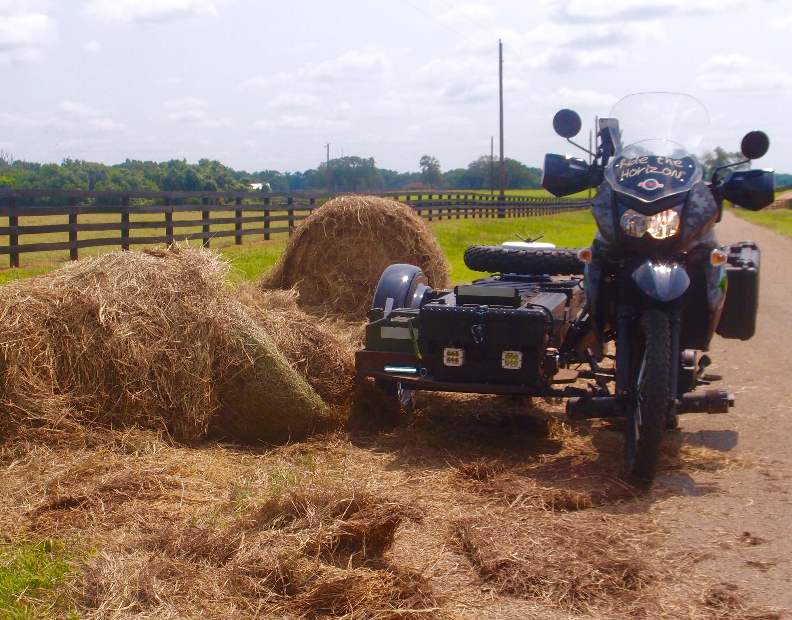

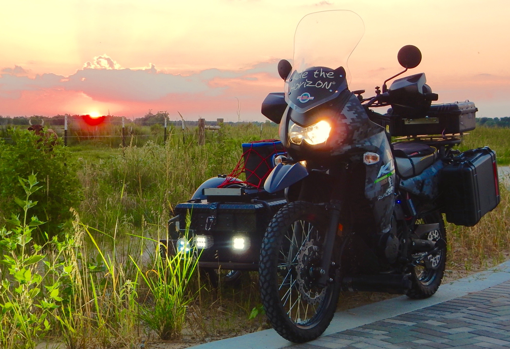

Jerry, I had the same requirements as you for a KLR based adventure rig. Finally ordered a sidecar chassis from DMC with their KLR subframe. Then built out the rest with the features I thought I needed, extra fuel, fully mounted spare tire, lockable waterproof storage, etc...
Am very pleased with the final product. Can cruise all day on pavement or follow a Jeep trail when in the mood. Have taken it on national forest 4X4 trails and sections of the Continental Divide. Naturally I dropped the gearing down for better climbing on rocky terrain but can still cruise at Ural speed. Be glad to answer any questions you have as you put together the right rig for you. CCjon
