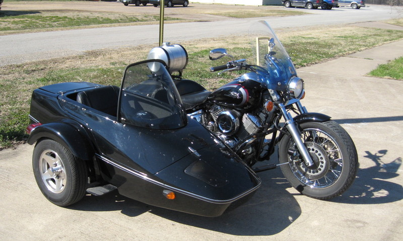

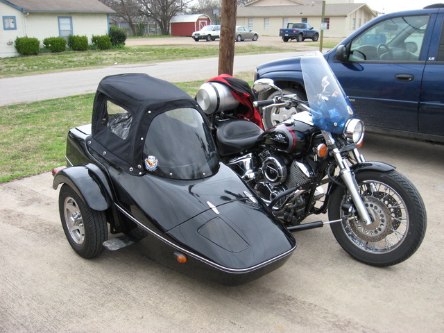

Hi! I'm him! I have the rig being discussed and I love it. I did have Dave install the steering damper which does increase the steering effort but then too it makes difficult or uneven road surfaces much easier to handle. The bike is low, solid, rock steady and fast. The V Star 1100 with the Hannigan Classic is a great combination. While you're at it get the optional convertible top. I don't use it a lot but when up it makes no difference at all to the handling characteristics or mileage and adds a lot to passenger comfort.
My bike is capable of speeds in excess of 90 (don't ask how I know this) and is just as steady at high speeds as low.
I bought the bike from David and brought it back to Texas after only a 25 mile or so "follow me" ride behind Dave. When I say "brought it back" I mean, "I rode it." 652.6 miles in 14 hours with three stops to top off the tanks. Dave mounted a 4.5 gallon Tour Tank before I left KY. That gives about 330 miles between the 2 tanks (9 gallons). Perhaps that kind of mileage isn't what might be recommended but it was February and I wanted to be home. (I left KY with icicles hanging from the car.)
If Dave says it's good then believe every word. My usual passenger weighs in at about 200 lbs. and his weight makes very little difference in the handling. With no passenger I use no ballast in the car to compensate and it still feels secure on the road at all speeds.
I'm delighted with this combination and even though I saw lots of great bikes in the showroom at Hannigan's I didn't see any I'd rather have than the one I bought. I still haven't! I'm definitely a satisfied customer!

When I bought the bike sight unseen (except for one picture) Dave was concerned about whether I was going to be pleased. I am. It's a great combination! The top tends to leak just a little around the side edges but I'm sure that's going to be pretty common. Without the top I might as well have been hauling a bath tub today. It was pouring rain in places!
Extras on my bike include the tour tank in place of the pillion seat, driving lights on the front caliper mounts, solo rack mounted under the Tour Tank, Mustang seat mounted by Dave for himself (nice seat!), steering stabilizer, convertible top, ECC unit on the car (makes driving much easier), headlight modulator, back off unit, custom extra brake light
