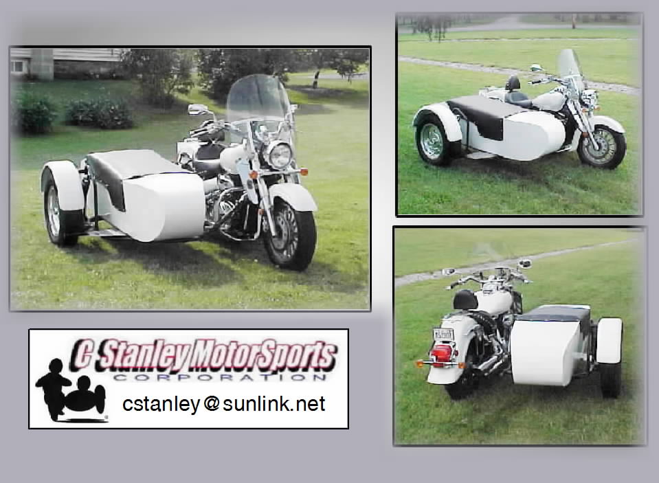

>> With all you have said I you still have a lot of options. For a pretty big bang for the large displacent v stars or other japanese cruisers do well with sidecars. The Suuki Bandiot and others are good choices as well. See pic below of one of our CSM1 sidecars on a C50 Suzuki<<
