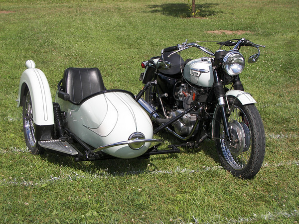

Here is a Cozy outfit we did a few years back.
Sidecar was lowered. We built a subframe and mounts. The 'universal mounts' offered though Cozy (actually Velorex mounts) did not work out well. It is mounted wide for additional stability and due to the bike being a kickstart only machine.
Posted : October 10, 2010 1:40 pm
