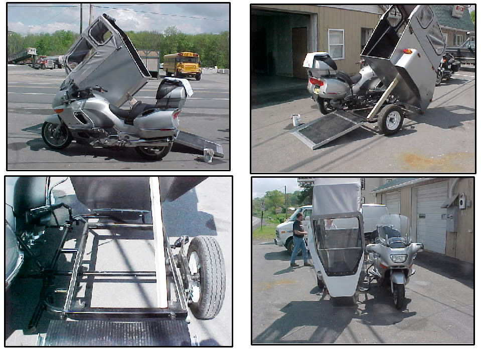

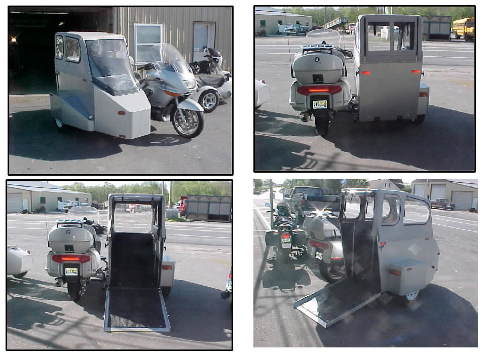

Attached are pics of a wheelchair accessible rig we recently finished. When we delivered it my wife JoAnne rode in it while sitting in a lawn chair 🙂
Note that the height of the body is what it is to accomodate the person in the wheel chair being in it. Without the wheelchair the body could be made much lower than pictured.
The flip front feature is to allow access to the right side saddlebag and also to get at the sidecar tire easily.
Any ideas related to a custom body can be discussed to allow easy entry and exit.

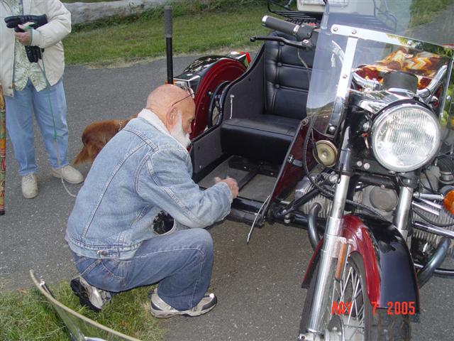

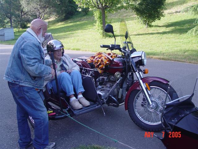

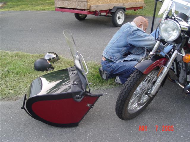

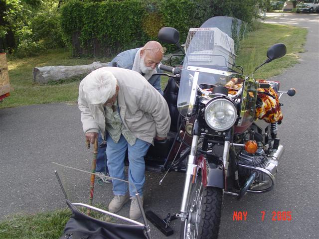

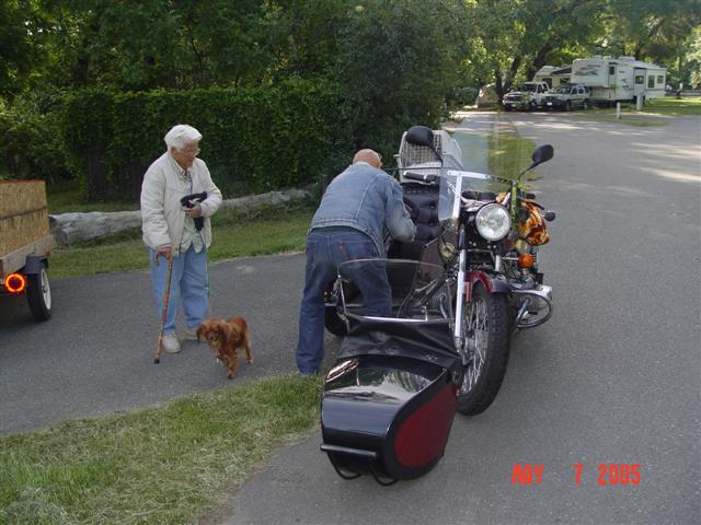

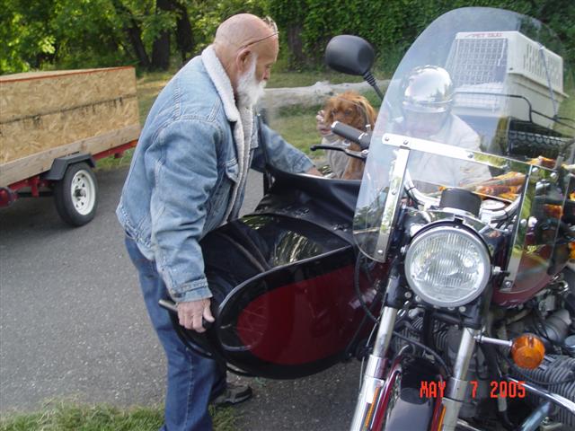

Sorry, but I hadn't been to my photobucket account in many months, so I didn't have ready access to the pics of the Ural that had been modified for handicap access. I just found them and hope it may be of some help in allowing you to see at least one other idea for access. I tried to speak to the fellow about how he modified the Ural, but I have never been able to do so. I heard that his wife has since passed away, but he still rides I have been told. I don't know his name or email, but these photos have been at the IMZ site in the past. The photos are not in any particular order. There are probably some more photos as well, but these were all I could locate.
I have a Troyka just like this one, so I was interested in what all it took to modify the hack in the same manner and still keep it safe. I also wanted it done to where it looked like a factory option and not an amature body job.
Hope it helps give some ideas.

That looks like a great way to simplify access. I'd like to see more details. Maybe the owner or someone who knows him is out here.

I guess someone at the IMZ website knows him, but I don't. I had a few questions about it that I'd like answers to as well. I couldn't see up close enough in the photos to determine how it all worked or pieced together. I sort of wondered if the nose kept getting scratched up when he lay it on the asphault all the time. I also wondered exactly how much weight was on that nose section. I've had two shoulder surgeries, so anything heavy is sometimes tricky for me to handle. Holding the nose and alighning it with a pin or such would probably be a chore for my right arm to handle. I'd like to see how secure the nose is when it is on the rig and buttoned up. I sure would like to actually see the rig or find out how it was all done. I suppose one could even make a fiberglass nose section to reduce weight.
Posted : June 22, 2008 3:39 pm
Some of it I can figure out. If you look at the first and third photos you can see that when he cut the nose off he put a peg in the pipe that goes around the top edge. There's also something across the bottom edge(picture 5), in front of the sidecar frame, but I can't make out just what it is. Likewise, there's a "T" on the floor in picture 5 and on the ground in picture 6? I'm guessing the front bumper extends under the nose to that tube on the frame. Maybe it's actually a set of short pipes, some on nose and some on body, that line up with a full width pin that allows it to pivot down and is then removed to pull off the front. Kind of like this, . On each side of the body I can see a latch that would pull it tight. The two pipes of the front bumper would be effective in protecting the bodywork when it was set on the ground.
Can't figure out that T though. Anybody else have an idea?
Posted : June 22, 2008 4:19 pm
The T shaped item is a lock to hold the sliding seat in the rearward position. In picture 6, the seat is moved to the forward position. In picture 5, the lock (seat keeper) is being released and or removed from the car. The front bumper is a handle for the right hand to use to get a grip on the moving section of the body. The left hand grips the hand rail. The item across the lower edge looks to be a foam pad to protect legs and clothes from a sharp edge. This is what I see but I have been wrong at least twice in my life.
Posted : June 22, 2008 6:54 pm
I guess that it would be overly simplistic to have a hinge set up on the outboard side and clamps on the inboard side. That way, the pilot could come around and unhook the inboard clamps and swing the nose outward so that the passenger could exit out front. Lot of weight on a hinge, so maybe that would be just too simplistic and idea. However, it sure looks involved in him having to do all the work just to get this nose unhooked and then put back into place. It would likely be no fun at all in doing so in the rain or such.
