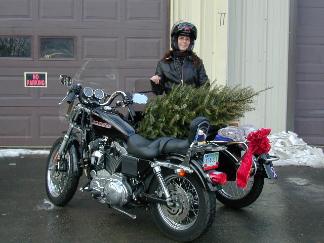

Hey Uncle Ernie,
I have a Sportster 1200 w/ Cozy Euro..great for kids dog groceries dumpruns Christmas trees and small adults handles great.
my Sporty is quite peppy...
Happy Healthy many carefree safe rides New Year!
Liz

Miss Liz - that was a great pic of your Sporty and Christmas tree 🙂 The smile on your face is a big reason sidecars appeal to me - I've seen that smile on many pictures of hack owners. There must be something to it!

Dave,
You bet! Having a great time with her..this is my first bike/rig, always
wanted a sidecar...(beats being an ornament on the back!)
People that stop to look/see always talk about good memories with the thrill of a child ,remembering grandparents and childhood memories of sidecars ...always leaving with a smile after sharing.
