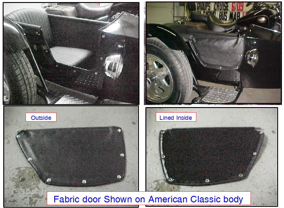

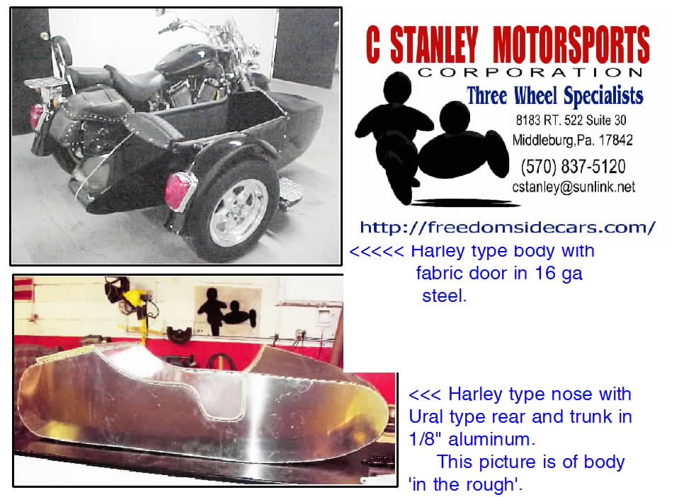

We (C Stanley Motorsports Inc.) also do a body similar to a '36-67 Harley. These bodies can be done in 16 ga steel or 1/8" aluminum. They can have a fabric door or a metal door built in.
The bodies are basically built to order and being as they are metal modifications are not out of the question. The pic below shows one with a harley type front on it and a larger rear section for more trunk space.
