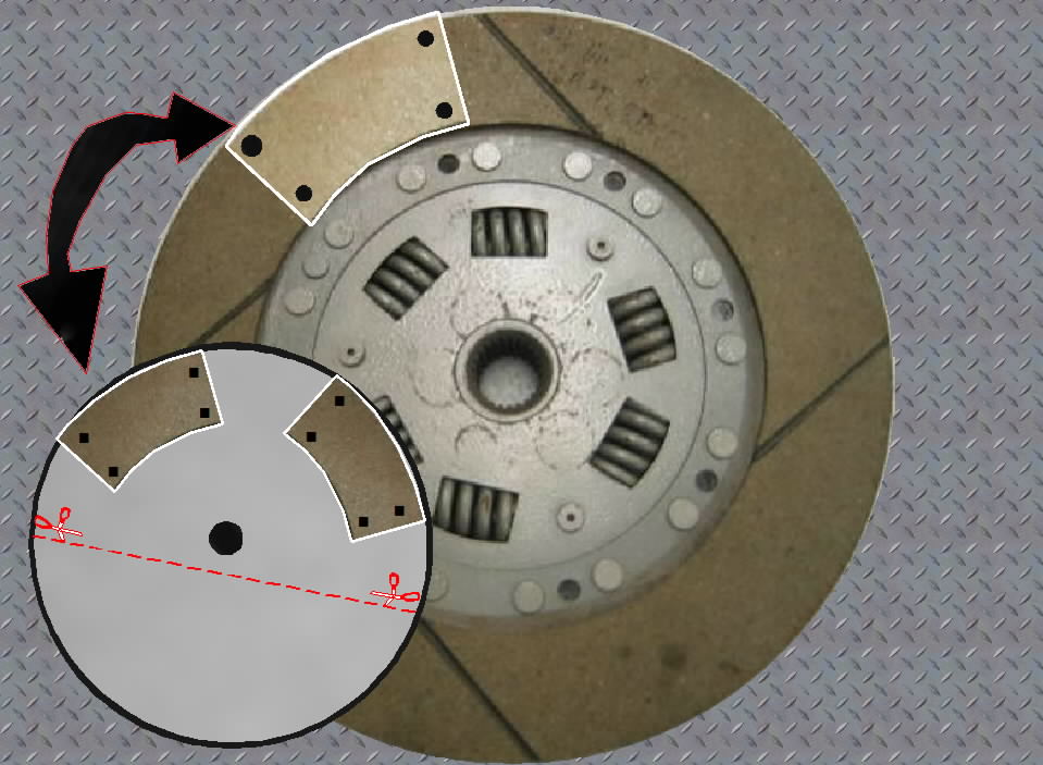

Possibly some disc brake pads would work also. Could be cut down as required. Or you could cut pieces out of a clutch disc? You really don't need a full circle although it woudl be nice.
see attached
