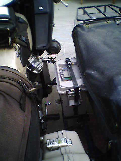

I bought my rig already set up with a 15 inches of lead (leed, not led) on my sidecar wheel which is a lot. I loaded most of my stuff behind the seat of the sidecar. As I learned to ride this quirky vehicle, I noticed that the front tire liked to wash out on left hand turns. This became a real issue in the winter. I tried several different front tires and air pressures for better traction. Then I figured out that enough of my cargo was outside the tipping line between the sidecar tire and the rear tire that the front was getting light on left hand turns. I mounted the 15 to 20 lb. tool box outside, between the sidecar body and my right foot and the problem diminished measurably. Sidecars have an ungodly amount of variables to sort out.I think that is half the adventure.

15" of 'leed' is a lot of 'leed' but Mark I personally like to run more than most myself. Problem is that with more lead what you experienced can be the result in left handers. The front wheel will break traction easier than with less lead. Think of a car with two front wheels and only one of them steering and it starts to make sense. Excessive lead can also aggrivate a wobble if a rig has a tendancy to have one. It also will allow the sidecar wheel to come up easier in right handers. But...it will add stability in hard lefts once the front wheel traction is dealt with. Some rigs are pretty predictable in a controlled understeer position (front wheel sliding). A powerful rig with a lot of lead can over come the understeer by breaking traction at the rear under power. This is a touchy balance and takes practice to do. You can probably do it well on loose surface with your rig.
As far as this thread goes, related to ballst, I don't want anyone to get the impression that ballast shoudl be placed where Mark polaced his. Most rigs with few exceptions are adding ballast to stabilze th erig in right handers and the best placement is out near the sidecar wheel and typically behind it.

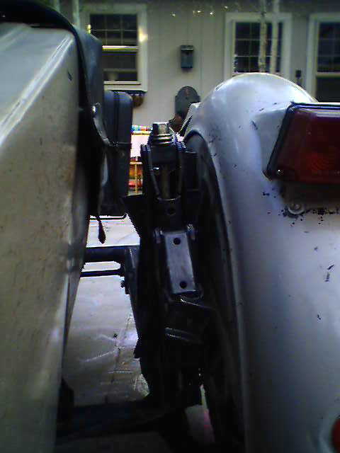

The tool box is only the heaviest portion of what I carry. I mounted my scissors jack on the sidecar shock absorber post. I also carry a 12 volt air compressor, jumper cables, ground cloth, inner tube,and a small back pack for Search and Rescue behind the seat.
The lead was determined by the Dauntless sub frame that was on the bike when I bought it. I does not allow much adjustment for lead. As with all rigs I imagine, you learn the quirks and adapt your riding style. I've only had this rig about 3 years. It's my first,so I don't have anything to compare to. It's all good to me.
