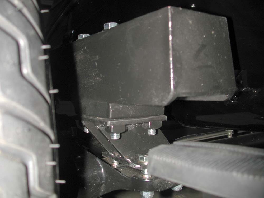

Well I did it today. I finally got everything hooked up last friday night. Spent about half of saturday adjusting the car, untill I got it as good as I could. I've been riding it everyday to and from work to get used to riding with three wheels. Slowly taking turns alittle bit faster each time as I get more experience riding with a sidecar. I slowed down for the right hand turn onto my street. While in the turn I rolled on the throttle and the car came off the ground a few inches, then came back down right away.
I need to fab up something for ballist, and was thinking about something that will attach to the sidecar frame since the tub sits on leaf springs.
Posted : August 16, 2007 3:07 pm

Harley-Davidson used to sell a 46# cast iron sidecar weight but they've been discontinued. One difficulty was that the weight would hit the sidecar tub and scratch it when hitting bumps. I couldn't find one of the OEM weights for my TLE sidecar so I made my own. Mine is very similar to the HD OEM weights. It's made out of 1/4" steel plate welded from the inside to keep the exterior clean. It's about 12" X 3" X 3" and is bolted to the right side spring pad. I turned it over and filled it with lead that I melted and poured in place. It weighs about 50 pounds with the mount and bolts. It sure keeps the wheel on the ground.
Since it was too close to the body I also fabricated a cantilever mount to raise the weight 2" and move it ouboard about 1-3/4" so it won't strike the tub.
Here's a picture.
Posted : August 16, 2007 3:44 pm
That weight is pritty much what I had in mind. And that's exactly where I want to bolt it up. I don't want the tub to hit the weight when ever I hit a bump, and that offset should move it over enough so that nothing hits.
