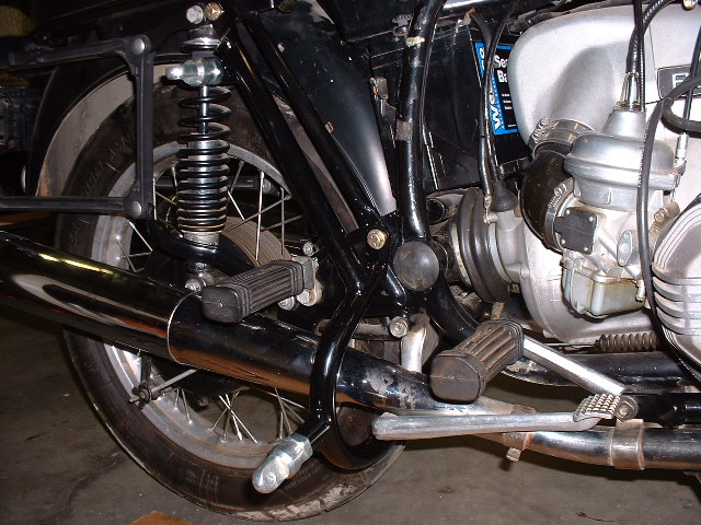

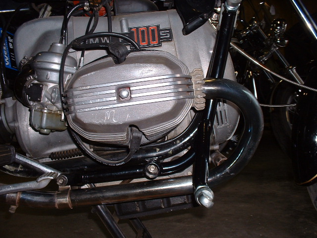

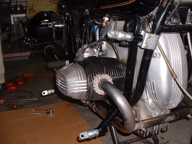

The statement speaks for itself. The Neff sub-frame addresses one side of the frame (as do the ones I build). The Dauntless unit attaches to both sides of the rear frame. Obviously a sturdier mounting.
Neither of the three (including mine) have ever failed in service to my knowledge.
Chauvinism aside I have no qualms with your choice of sub-frames and have no interest in debating the subject.
Having mounted (and remounted) many Beemers with my own fabricated sub-frames and other's products I will say I have never had to return a Dauntless sub-frame because it wouldn't fit on the bike it was made for.
I'll let it go at that.
As I've said here before: I'm no engineer, but I've been on a lot of freight trains.
Posted : April 10, 2009 5:38 am
Lonnie, Thank you for posting the pictures. The Dauntless subframe appears to be well constructed. Both have design features that are appealing for different reasons. The Neff design uses the engine as a primary stressed member, but it requires welding for the upper front mount. The two-piece Dauntless design requires no welding, but transfers larger torsional forces to the bike frame. For fast installation on a fully assembled bike, the Dauntless is a more practical choice. If that is all you meant to say, then I missed your intent. In my personal opinion, the Neff design keeps the F&R wheels closer to their intended locations with higher torsional rigidity. However, destructive testing or finite element analysis would be required to rank the designs in terms of stress limits. Superiority is a moot point if both are serviceable. Enough said...
