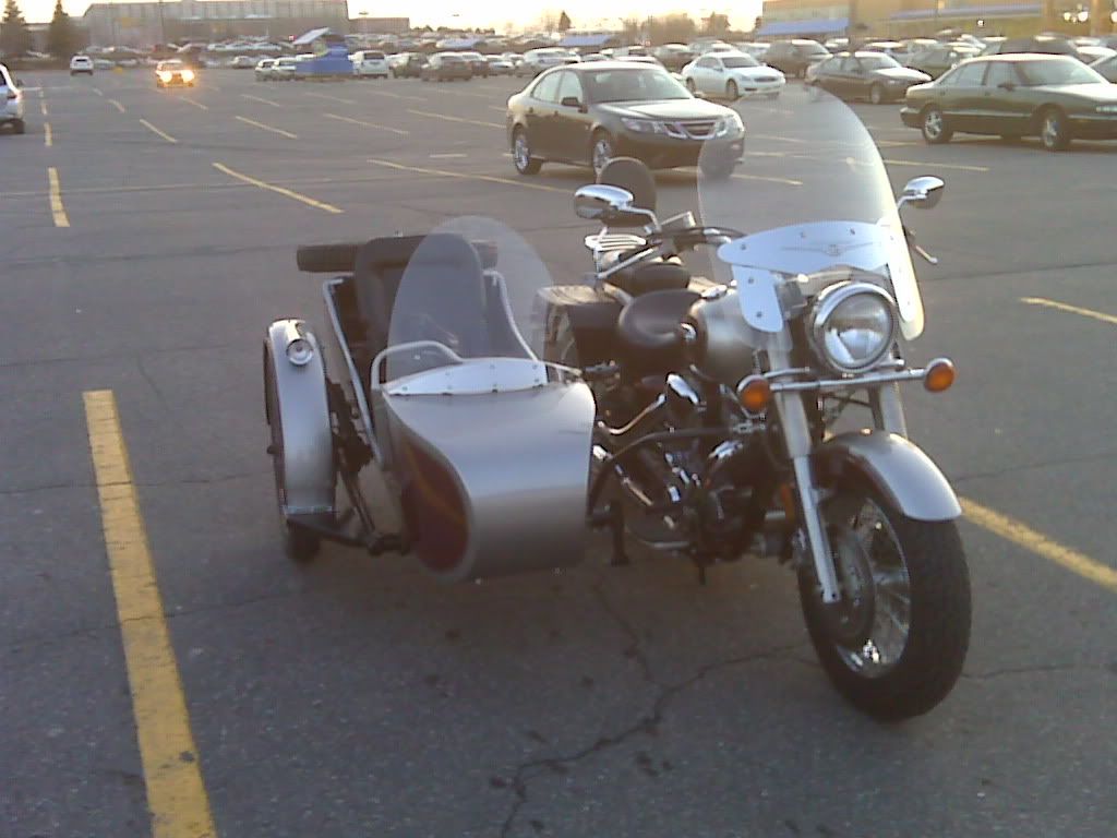

I had intended to get a subframe before the sidecar arrived, but I just recieved this from the guy that's sending me the sidecar....
"You mentioned connecting the side car to the BMW Solo, the sidecar i give you includes all the connecting parts to BMW Solo. But you need to install the parts on your BMW. I myself has a BMW R80, i also installed a CJ side car on it, attached is the picture.
Hopefully it will come with a subframe. I will wait to see what connecting gear arrives.

Hi Mick,Can you post the picture?
Posted : April 9, 2009 7:08 pm
Sure can.
Well I would if I knew how to do it 🙂
Here's a direct link.
Posted : April 9, 2009 7:19 pm

Show me a pick of the CJ you bought. Photobucket
