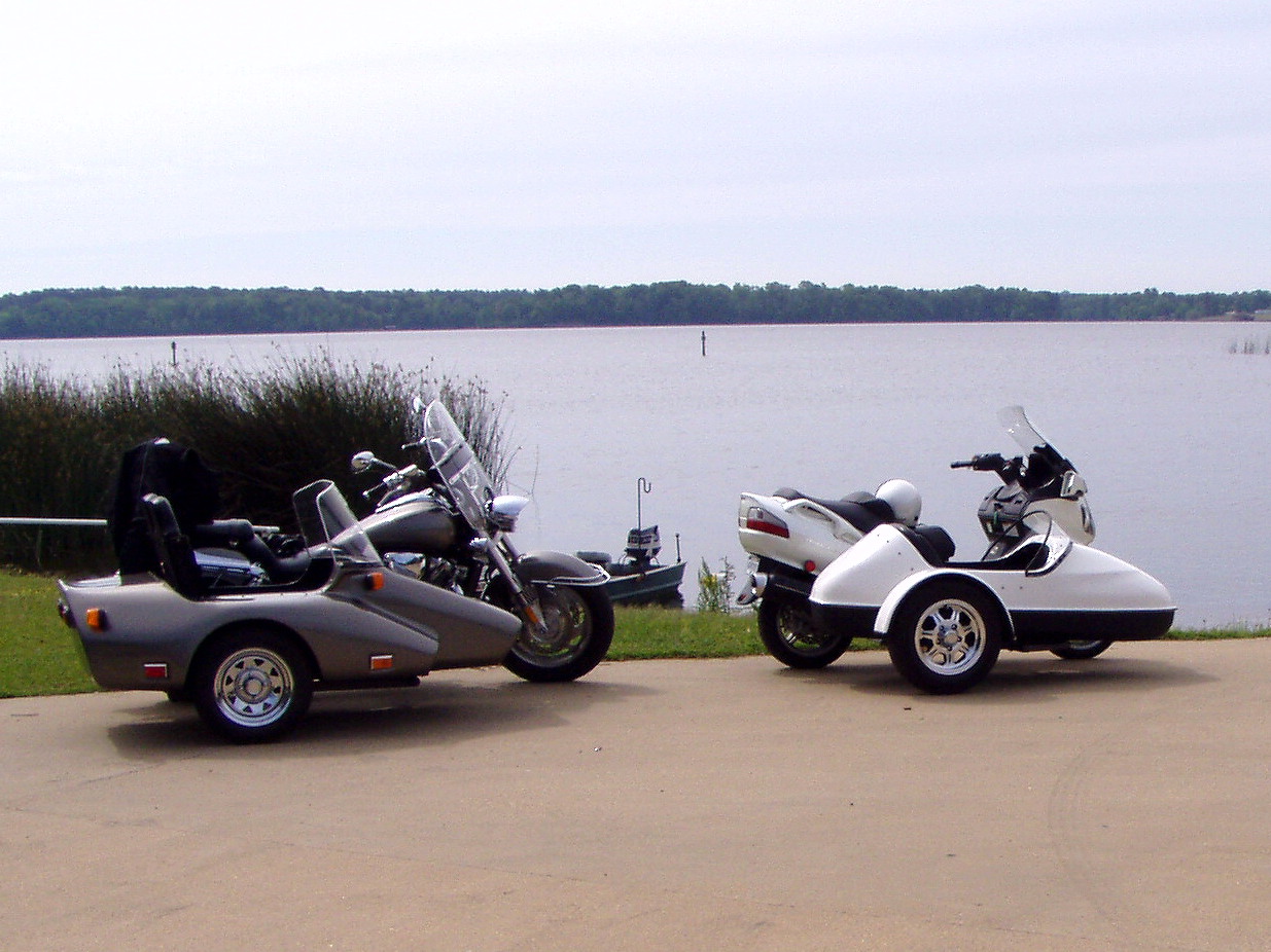

Roy, here's some food for thought. You may already have a workable bike. If I understand correctly, you now have a VTX1300. I've seen photos of VTX1300's mounted to Velorex, Texas & Champion sidecars - steering modifications may also be available as well. A fellow here in the neighborhood has a Kenna double mounted to a VTX1800. Attached is a recent photo of the VTX1800/Kenna rig along with Jena's Burgman/Texas rig. Also, there is a dealer/installer in NW Louisiana: www.jnjsidecarsandtrikes.com.
