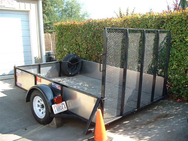

I ordered a custom 12' Haulmark Low-Hauler for my rigs and after driving from Marysville, WA to Provo, Utah to pick it up, found it was not wide enough for a Factory Harley rig.
As a result I built a 9' open drive on ramp trailer with a 13" high deck for picking up sidecar rigs. A late GL outfit is a bit too long to close the tailgate all the way but I don't haul them too often anyway.
