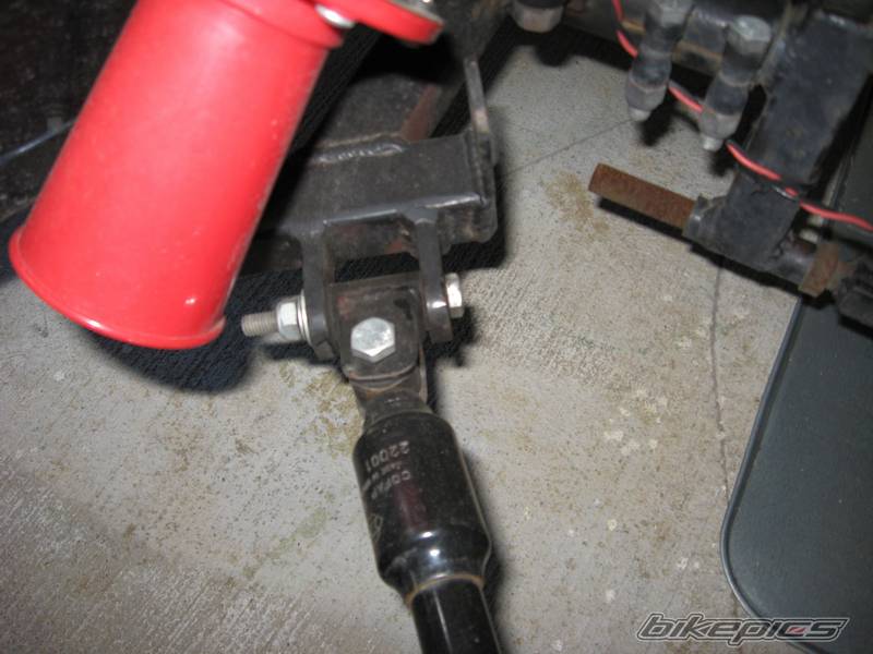

I build my own from scratch and a VW beetle damper. I make a universal joint that gets welded to the sidecar frame and a fitting that incorporated a heim joint on the fork leg.
And the site again refuses to let me post photos
Posted : August 2, 2015 5:13 pm

Not only does this site refuse to allow me to post photos, it won't let me edit my post to tell of it.
Posted : August 2, 2015 5:22 pm
Phelonius - 8/2/2015 11:13 PM
I build my own from scratch and a VW beetle damper. I make a universal joint that gets welded to the sidecar frame and a fitting that incorporated a heim joint on the fork leg:
Posted : August 2, 2015 5:37 pm
Well there's one of the photos I was going to post. How did you do that?
Posted : August 2, 2015 7:42 pm
