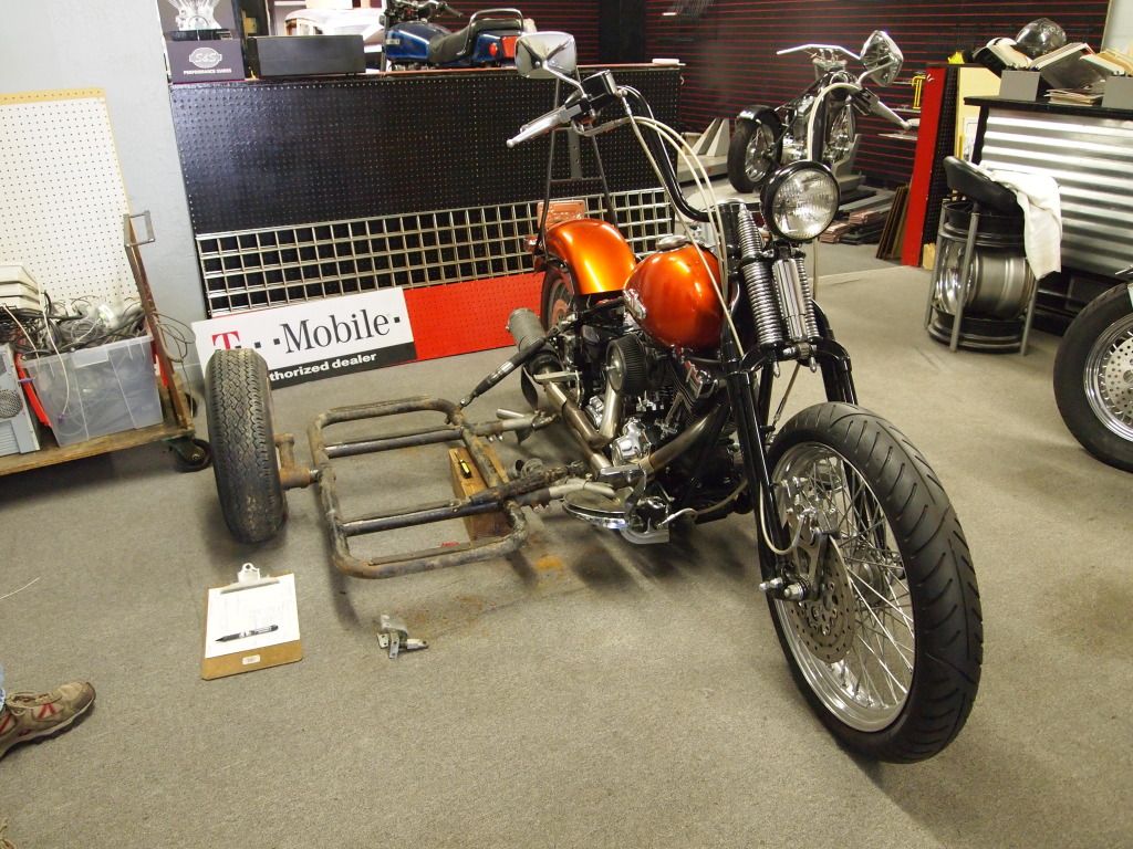

Well after almost 2 months of challenging modifications to my exhaust and custom built brackets needed to use my forward controls my California Sidecar Friendship 1 it is finally mated to my Harley Softail motorcycle. Took it apart Saturday to be cleaned up and then some powder coating and paint. He is a picture with is still attached.

There really isn't a law that says there MUST be four attachment points. A single sturdy diagonal attached behind the seat would get the job done and not interfear with a set of forward controls.
