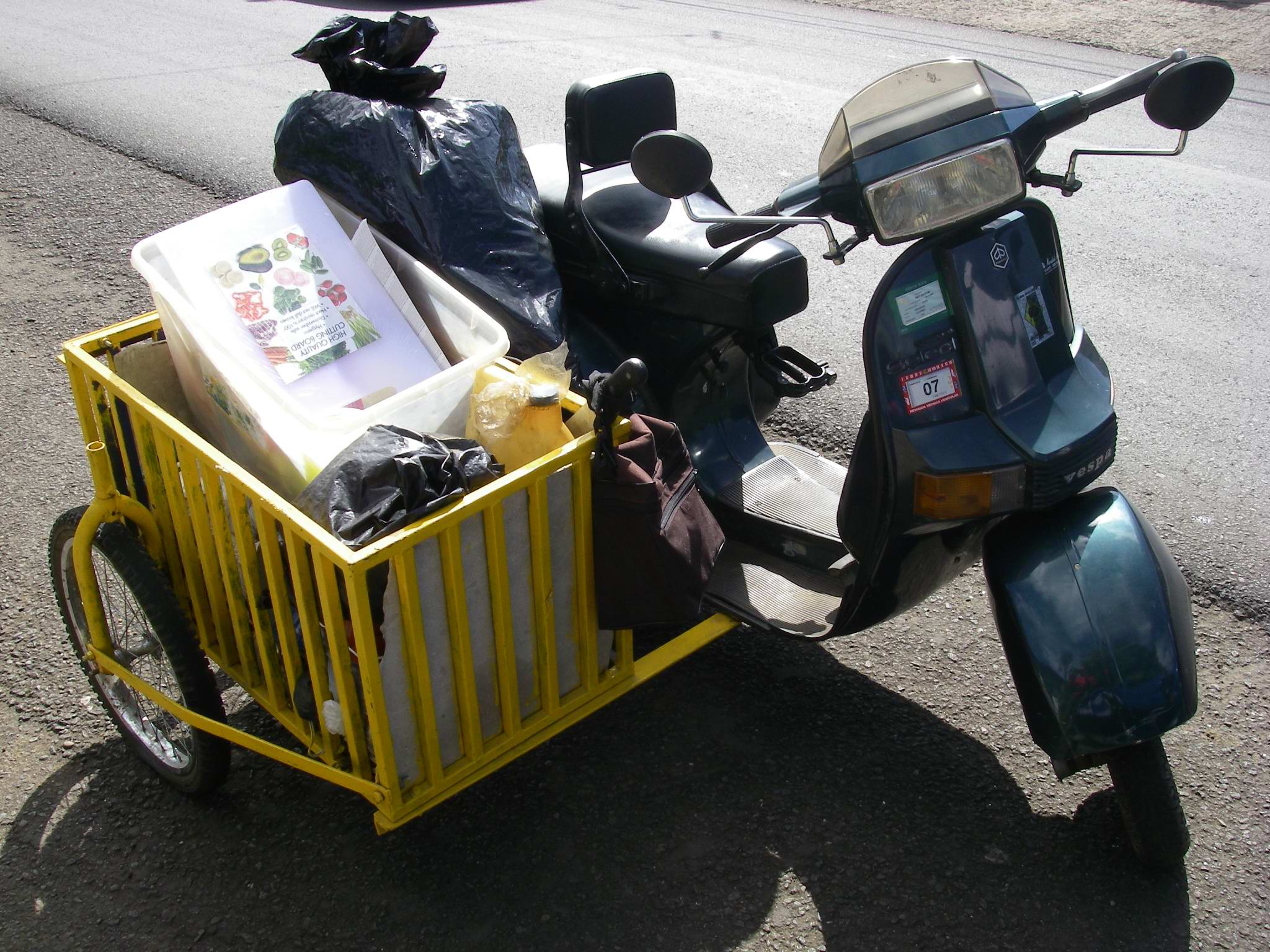

Nuts!
1*1" tubing comes out like the vespa in the foto....
A friend took 2 years until he had "his" personal design optimized and a decent handling.
The design is the secret. its not done with a few wellding hours.
Safety first!

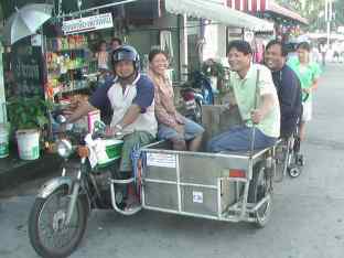

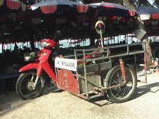

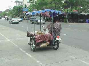

In Thailand, you see lots of light weight sidecars attached to 100~125cc bike.
They use steel (?) plumbing pipes and swing arm / shock / tire taken from junk motorcycle.
But over there, cost is the first, safety the last.
Posted : December 12, 2007 10:53 am
Here are some pics from Thailand.
