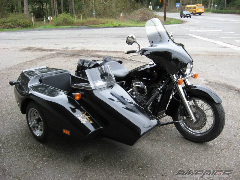

This 750 Aero has been serving me as primary transportation for 5 years now. 40 + MPG
Lots of pretty girls doing drive by shootings.
Posted : July 9, 2014 6:19 am
Phelonius - 7/9/2014 12:19 PM
Phelonius,
What brand/model is your sidecar? Love the look!
Jeff
Posted : July 9, 2014 6:22 am

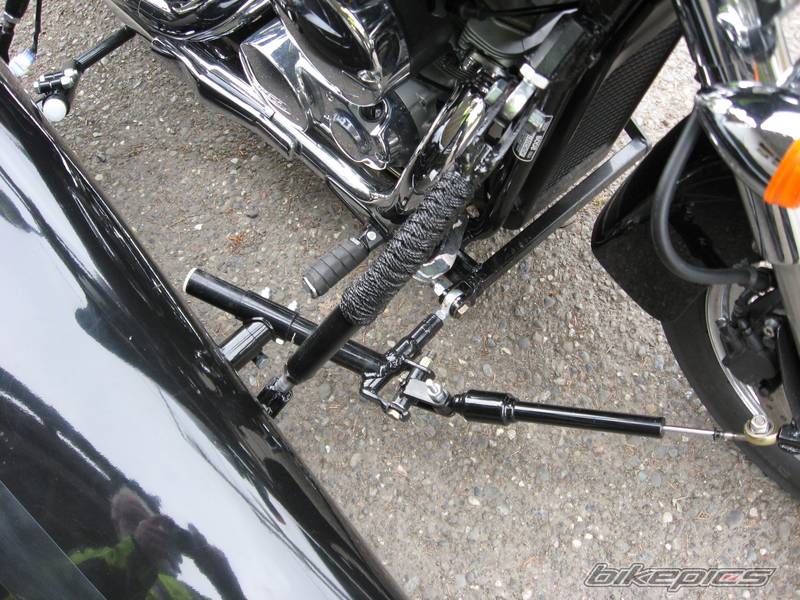

It is a Kenna. The swing arm pivot point is behind the wheel axle. This makes it take bumps very gracefully.
I did this on a sidecar I built earlier and it is one of the reasons I chose Kenna.
