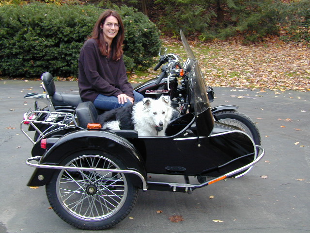

I am a newbie enjoying my Sportster (1200) with Cozy Euro,
How much weight do I need in an empty car?
Locally was told 100# for me pulls too much, I gather I need to find my wt zone but would like some opiions from the seasoned rider, Thanks

Too much pull (to the right?) with the extra weight usually means too little toe-in/lean-out, or both. Align the rig for neutral steering regardless of ballast or passenger weight. check your sidecar tire tread wear down the road a bit. Look for even wear with no scrubbing either way.

Your wrench has a Harley/Harley rig. Many of the Harley rigs use a negative lean or a lean-in. That is not the case with the Sporty/Cozy outfit. You will need some positive lean-out to achieve neutral steering.
I would suggest that you not try to lighten the ballast load too soon. Your bike probably weighs well over 700# with you aboard and the Cozy is a light sidecar. You mentioned a using 70# ballast weight in your posts. If that is a sand tube be sure to place it as far to the rear of the sidecar as possible to prevent nose dive in the case of a sudden stop or to prevent rear wheel lift in a quick stop when doing a left hand turn.

Presently still with 50# (crushed rock) placed on seat handling well, the 2nd 50#I think sets the car off balance as you hinted nose heavey possibly.
I am taking it slow learning turns stops etc.
The sand tubes are on back order, hope I can "wrap" the tube on the floor front of seat do you suggest wt on wheel side or left inner?

Try to keep ballast as far out and to the rear as possible as was noted. Also it is no big deal to make ballast a permanent thing if it works for you and keeps things stable. There are some who feel they are better sidecsarists or have a feather in their hat for running lighter. DON;T WORRY ABOUT IT just have fun, be safe and keep practicing. All ballast is is weight added to make up for a sidecar that may be a little too light for the bike.
Pulling to the right is not due to ballast it is due to the setup being wrong when ballst is added.Taking out ballast could make it run straighter but if the sidecar is too light then adding ballast and re adjusting the setup makes much more sense.
Widening the track width is also a good way to add stability.

Thank you. Funny is when I have a human in the side w/ no extra ballist easier handling, had my rig checked out by a seasoned rider, thinks that my wt distrabution is off. (with the 2nd 50# on floor)
