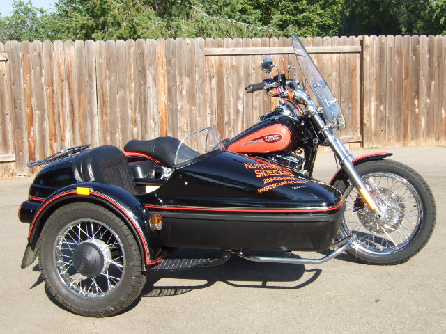

If you replace the stock muffler bearing (bushing) with a Yugo wheel bearing (which has the same outer race diameter) you can slip in a Yugo spindle and notch the end for the eye bolt connection. This is easier than finding the right size lefthand threaded nut.
These parts are easily found at your local Yugo or Tucker dealer.
F 16 and sunny here. When it reaches a balmy F 20 me Mum and I are going for our 48th annual New Years day ride. (She made me put a windshield on the Hack for this event, Claimed this one was too short (the Wuss).

Lonnie, nice pic but it doesn't show the yugo spindle mount. enjoy your ride...........fly
