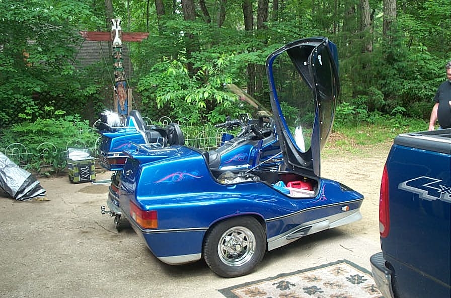

I like my Carlisle 145R12 on the Hannigan sidecar
