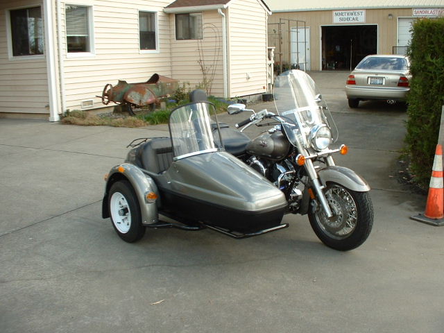

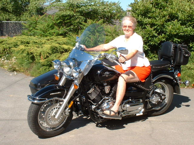

The V-Styars make fine tugs.
Here are a couple we've hacked.

Thanks, guys!! That's kinda what I was thinking...looks like a pretty torquey little engine, so should do well...
Nice to see it's already been done. Nice work, Lonnie...I particularly like the '02 1100...very nice...
