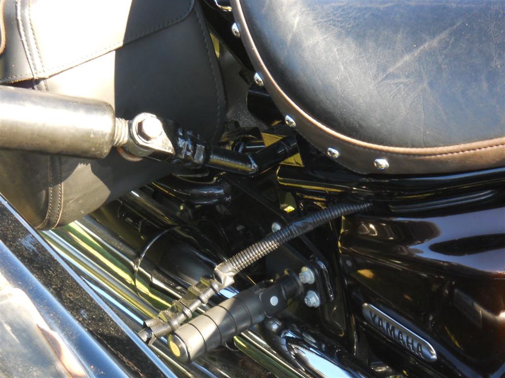

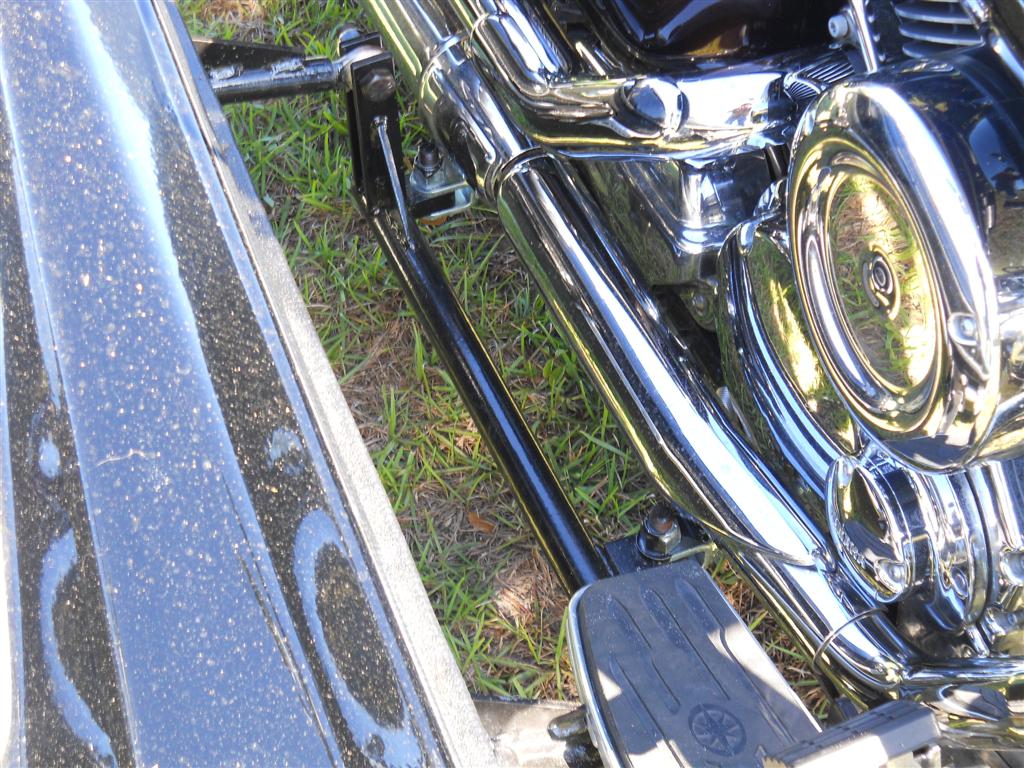

Recently got a great deal on a terraplane that is in like new condition. I would like to mount it to my 2005 Roadking. I have asked on the terraplane yahoo group for assistance and have recieved no response. All I am looking for is pictures of the mounts on a similar harley. I am reasonably sure I could fabricate them if not any advice is appreciated. Thanks, Tony

This is the only Terraplane rig I have any shots of that show 3 point mountings. I have mounted them with 4 mounts but not on late baggers.
For the RK a Motorvation subframe would be a good start having the bottom tube in line with the lower frame tube of the RK. The only problem with these is they don't want to clear speed bumps well.
The attached is not one of my sub-frames. The restored Vetter was mine.
