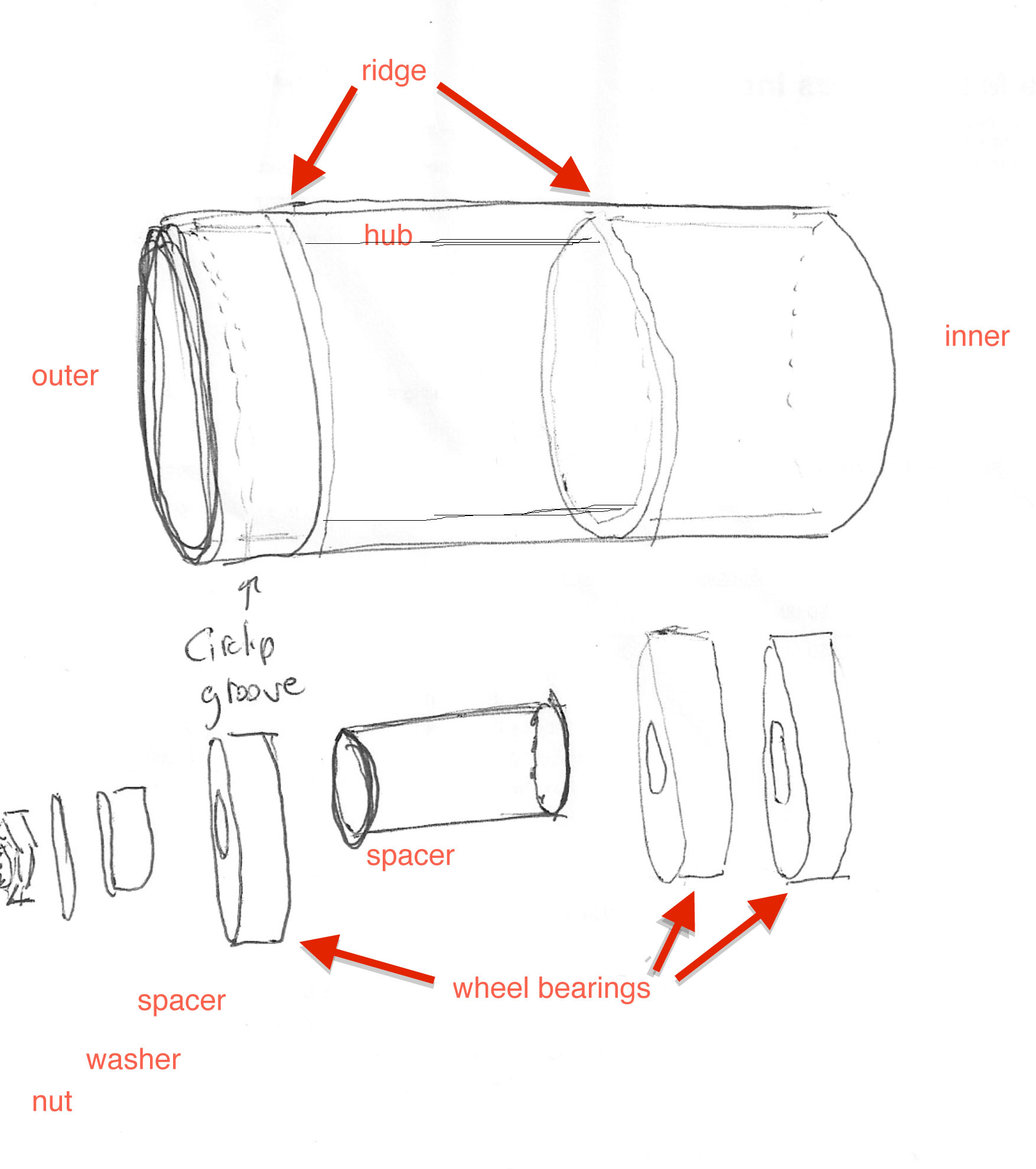

Attached diagram may or may not make this more clear. Accidentally omitted from the drawing are the circlip and washer which lies outboard of that.

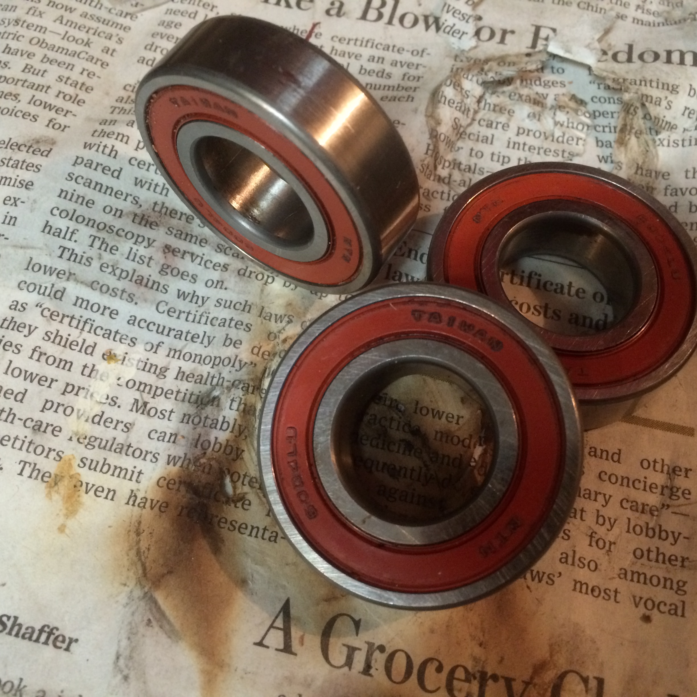

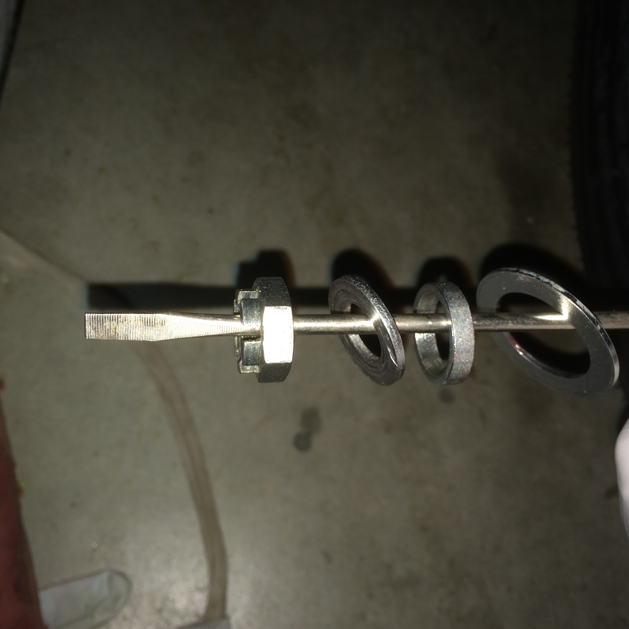

Thanks for the feedback guys. Jay I did verify that the axle is not bent with a straightedge. Al, I had looked at that diagram. I thought it might have referred to the older cars as it doesn't match my parts and seems to show unsealed bearings. The bearings I took out and that I replaced are sealed roller balls. Lonnie, I bought this sidecar used from you a few years ago. I think it was from an ad on this forum. A friend of yours who works in the North Dakota oilfields delivered it for me. I think you said it had been on some kind of Suzuki and didn't have many miles on it. It sure didn't seem to be very high mileage. I would be surprised if anyone had replaced these, but maybe. I must admit I have never seen 2 bearings stacked on top of each other directly like that before. When I took the wheel off originally the nut was sure not very snug. So what you are saying about backing off the nut is somewhat reassuring. The wheel spins free when nut is not very tight but starts to bind with about 10 pounds of torque which sure doesn't seem very tight to me. Pictures show the spacer and washers that lie outboard of the outer bearing and also the original bearings that I had replaced with same size SKF.

I can't speak for this with regards to sidecar experience, However I can in regards to the bearing set up. Sealed bearings are roller balls inside a sealed case not tapered rollers. When you have sealed bearings with the center collar design between the bearings the collar only touches the inner race of the bearings, the outer washer only touches the inner race of the bearing, the inner bearing should ride firmly against the back of the spindal on the inner race only. you want to tighten the nut so that the inner races are firmly secured to each other via the collar in that they can't shift or move on the spindal. the bearing placement in the hub determines proper wheel possition on the spindal, if your spacers are off on one side or the other or in the middle between the bearings, when you tighten them you are pulling the inner race away from the outer race and this makes them bind up. sealed bearing have to have constant pressure along the spindal or mounting point so that the bearings can turn freely and not move side to side. most sealed bearings I have installed over the years required very high torque values to keep them from being able to shift in the spindal under loads. most also have a clip or snap ring to insure correct placement in the hub, but not always
from looking at your drawing and the link added, you should be able to install the bearings in the hub, be sure to put the spacer or collar inside, it should create a tight fit no slack or space between the bearings and spacer, when installing in the hub use something just a fraction smaller than the outer race of the bearing to drive them into the hub, do not hit the inner race or apply pressure to it for installing. make sure your spindal has a squared off edge where the bearing mates up (at the seal )if not there may be a small washer with a tapered side needed to square it up then you should be able to just slide the hub on and tighten it, if this binds you have something that isn't matching up between the bearing config and the hub assy. itself
on a side note, I have seen applications where 2 bearings were stacked together, there is a small washer or spacer that goes between them to keep the inner races spaced just enough to not allow the outer races to touch
not saying this is correct in your application, just that I know it's done
Posted : April 2, 2015 2:55 am

Thanks for those points Ace and Sven. One of my problems is that I'm not sure which reference point to use, as far as how deep to seat the outer bearing. If I drive the outer bearing all the way onto its seat or outer ridge in my drawing it's about 1/8 inch deeper than the circlip. The spacer length makes the inner bearings then way outboard of the inner ridge or what you would normally think of as it's seat, by like 1/2 inch or so. So the inner bearing isn't riding on a seat. This arrangement does seem to place the wheel where it should be with respect to the brake hub, so that's what I'm going with. I admit it has been pretty finicky getting the spacer squared properly and perfectly concentric with the bearings' inner races so I probably need to do be more careful with that. The spacer doesn't have an outer collar that would centralize it within the hub like I have seen in other applications.

however I would advise you reconsider this a little, for your hub and bearing config to be correct and safe the inner bearing needs to be fully seated into the hub and the outer bearing needs to be fully seated into the hub with the spacer between them to allow you to tighten them properly on the axle, this allows the bearings to be tight on the axle and the hub to be tight between the bearings and nothing can shift or move under a load
if seating the inner bearing fully makes the hub ride back to far then you need to space it out, could be why there were 2 bearings, also if the hub is as deep as your drawing it may be designed that way. if it sits like it should then measure from the inner bearing to the ridge for the outer bearing and make your spacer that size
you can use a small socket or ratchet extention to align the spacer with the bearing for installing purposes
