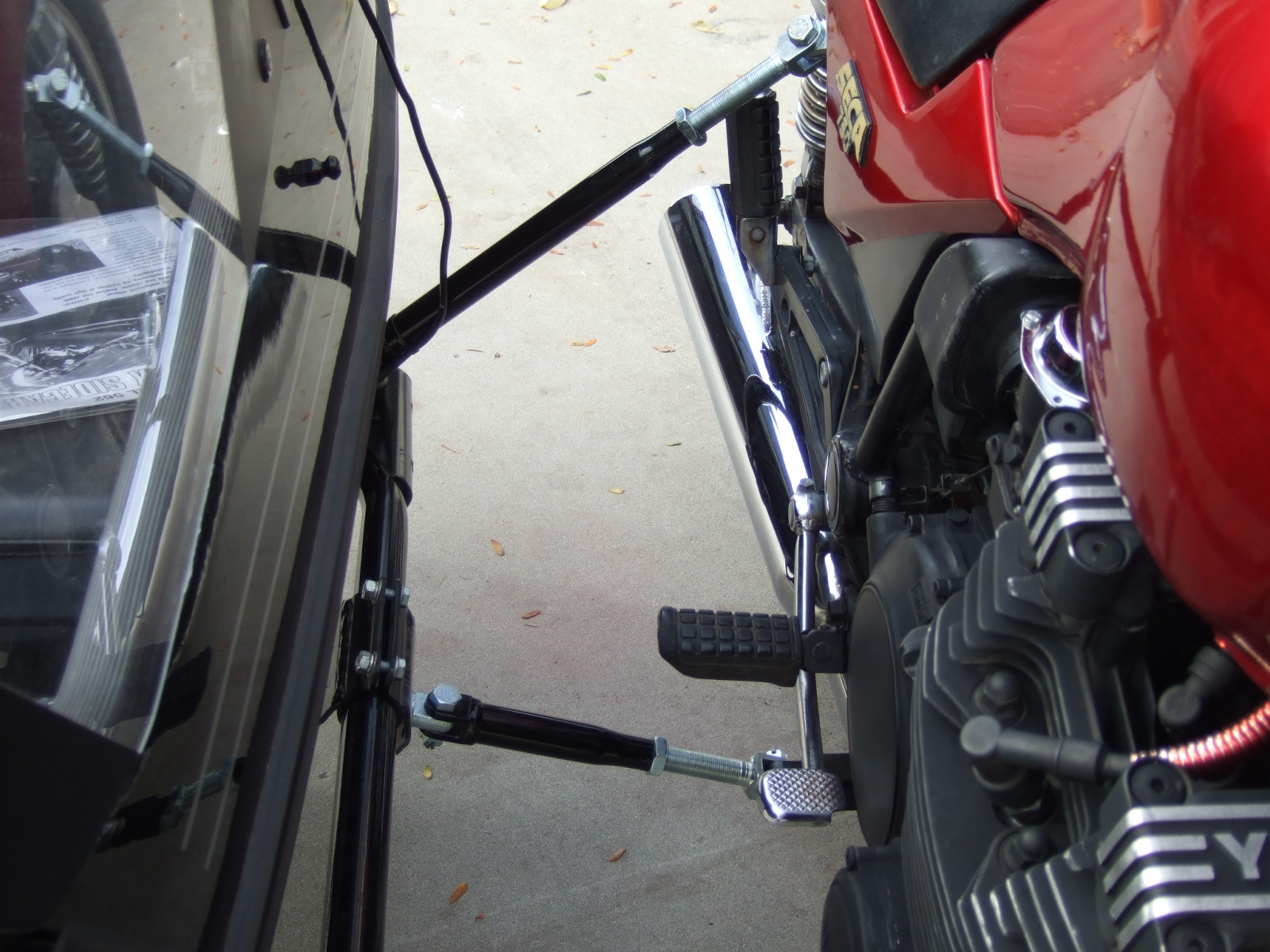

If it is mounted as shown here you won't have this problem.

Great view of front mountings, that will help a lot.
I don't have the mounting piece like shown in second photo that is attached to the bike. Can you advise me as to where I can get one. Although somewhat of a closeup I think I can figure out where it goes if I had one.
I am guessing the bottom-rear connection is simply 90 degrees to the motorcycle frame.

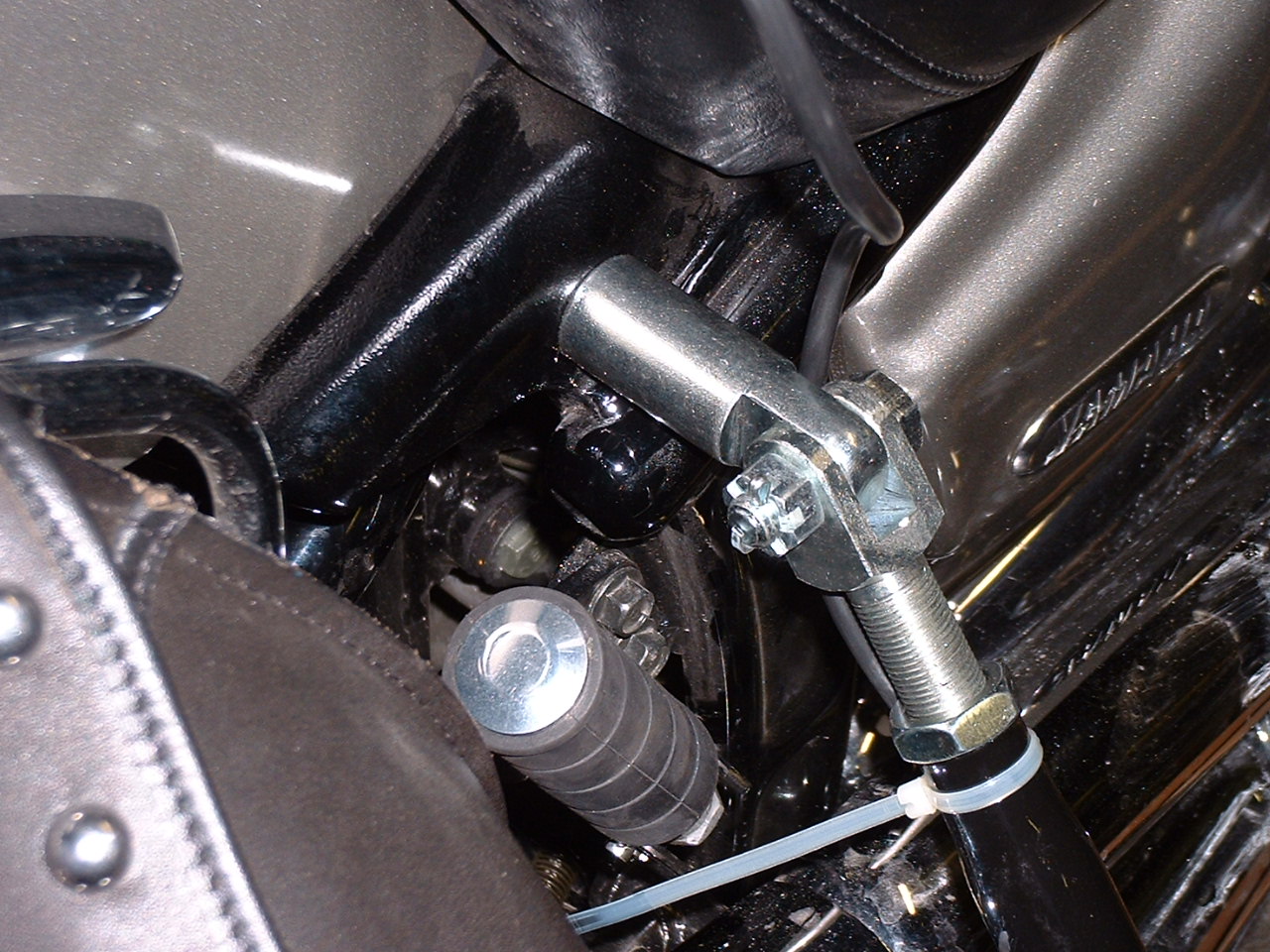

I got the 12mm threaded eyebolt from Perry's Motorcycles in Fort Worth, TX.

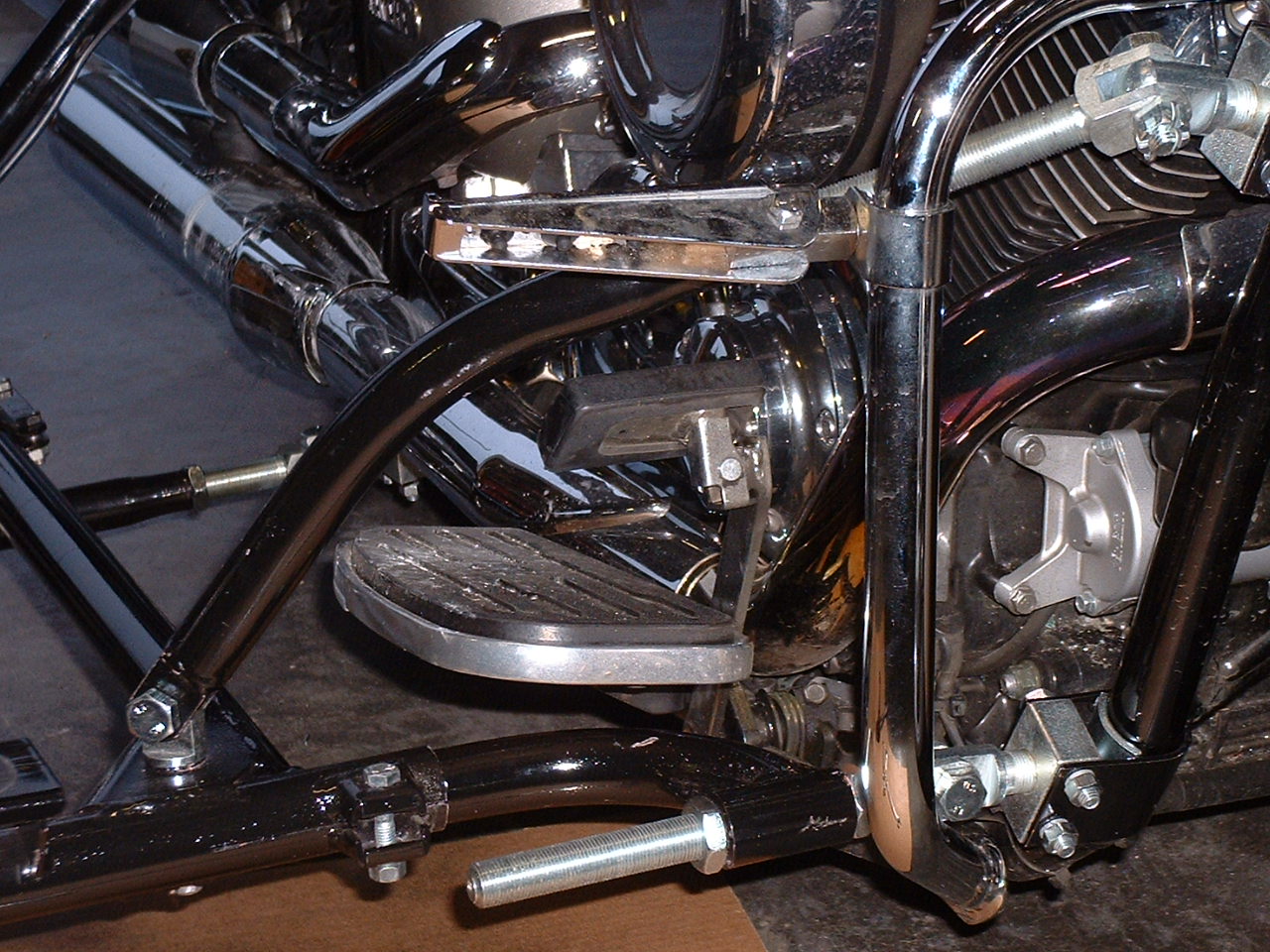

mount the sidecar end of your lower mount like tihs.
