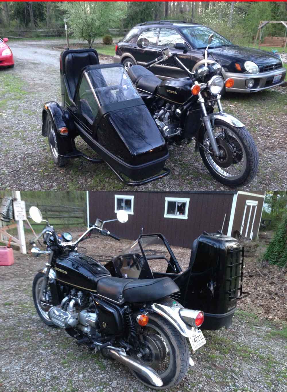

Hello everyone!
I purchased a mostly not running GL1000 with a like new Velorex 700.
My other setup is a CJ750.
I have the GL1000 restored and running well now.
The previous owner told me the hack was setup by "an expert" and that I should not make any modifications.
However, when I get up above 50mph she starts pulling to the right (hack side) and at highway speeds, where I plan to do most of my driving it is wearing my arms out keeping pressure steering away from the cart.
Here is my question:
Should I be looking into changing the Toe-In or Lean-In?
In all other ways the setup is very well behaved.

More lean-out will bring it back to neutral steering. Also check sidecar tire wear for toe-in problems. There is a center groove in the Mitas (OEM) tire. See if there is a rounding of one edge of this and a feathering on the other side. That will show which way the car is being pulled if these are present. If all is wearing even your toe-in is OK and you just need to tweak the lean-out till you have neutral steering at road speeds.

You might also want to check the sidecar wheel bearing, I had a pull to the right once, kept rechecking tow in and lean, finally got around to checking the wheel bearing and found it dry, over tight, and causing drag at highway speeds. Good luck with it.

I checked the tire, no unusual wear.
I turned out the top attachments 3 turns and it did seem to get better. I don't have a good level surface but I used a large square I had and it appears the bike has no noticeable lean in or out at this point.
I will give it a few more turns and try again tomorrow.
Posted : May 29, 2013 4:01 pm
First, The GL1000 is way to large of a bike for the Velorex sidecar. The Velorex sidecar was designed for a 350cc two stroke Jawa. The sidecar is to light, the frame is to light duty, the axle on it is only 15mm and the suspension is way to soft not leaving much of a safety margin. Also the drum brake more then likely was not hooked up as it is not easy to tie it into a disk brake bike.
Next issue is more then likely how is it mounted. Chances are your alignment has slipped, if it has not chances are it will. The Velorex "universal" frame clamps seldom work well and never can work well on a GL1000. The upper front may work ok, The upper rear could stand to be up higher then the frame tubes allow. The lower front ends up sitting on a part of the frame that is curving in two different directions both up and in and as this clamp also sets your wheel lead, more then likely your wheel lead is in correct. Wheel lead is how far the sidecar wheel is ahead of the rear wheel of the bike, It should be 10-15% of the wheel base of the bike. Your lower rear mount will be sitting higher then the lower front mount. This makes it very hard to find the "sweet" spot where all works well as when you lean the bike out 3 turns this causes the toe in setting to move out so while it now is not pulling chances are tire wear will suffer. The clamp on the lower rear on the sidecar frame is at best a poor design as it almost always slips unless welded down.
My first choice to fix all of this would be to change sidecars to one designed for a large heavy bike such as yours. As chances are you are not going to do this, my next choice would be to fix the mounts on the bike and up grade the shock/axle/wheel on the sidecar and weld down the clamp to the frame of the sidecar for the lower rear mount. While we do make a mounting kit for this bike, we will not sell it for use with the Velorex sidecar due to our safety first policy. If you were to make your own mount, the only tricky one is the lower rear. We remove the center stand and use its mounts as a pick up point, the mount moves aft about 6 inches more and also ties to the side of the bike. This places the lower rear mount on the same plane as the lower front mount so that when you adjust lean out you are not changing toe in.
You state that the bike appears to have not lean in or lean out. How would you know? When setting up a bike it must be done with your weight on the bike as this is how it is when you are riding the bike. We put lean out as you are in theory setting this up on a level floor. We want the bike to be straight up and down out on the road. Roads have a crown to them so we lean the bike out such that when it is out on the road it is straight up and down.
