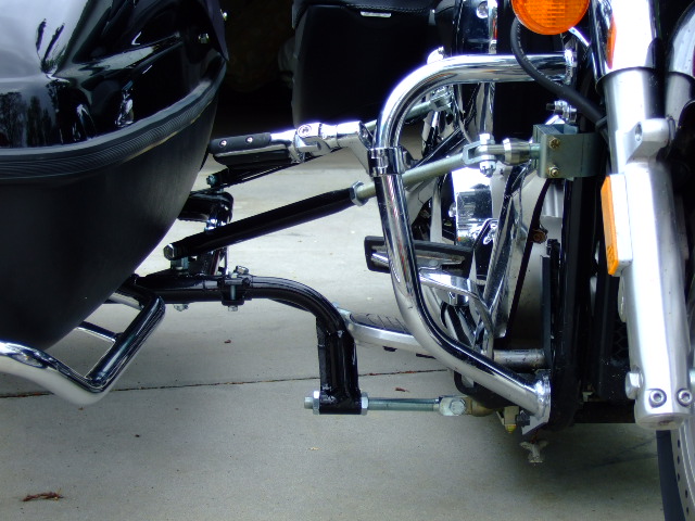

my problem is that i cant get the car level, in side is down about 2 inch
i cant get the front braket high enough to level it out
Posted : October 21, 2010 11:11 am

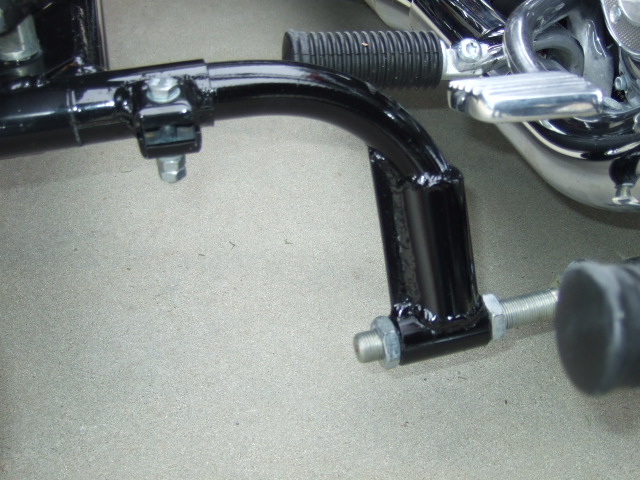

Clem,
Here is your answer. I do this modification on several Harley and Honda models to obtain an even sidecar mounting and get rid of the nose down rake.
Posted : October 21, 2010 1:00 pm

There are three different lengths of clevis bolts that come with the sidecar and they can be moved around to where they fit best or shortened to fit.
