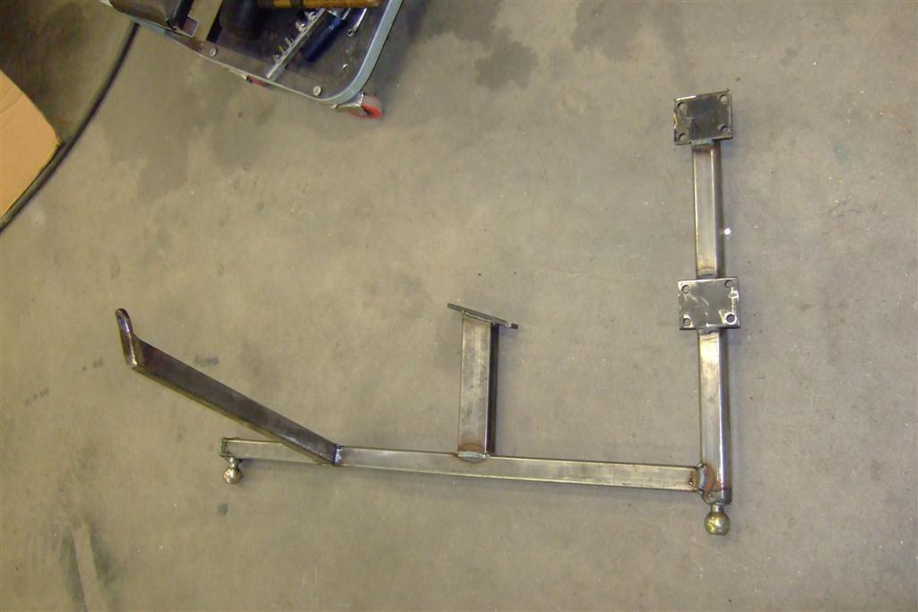

So I am about to the mounting stage of my Hitchhiker side car. The top two bracket are factory from some place that I bought from the previous owner (I am at least the 3rd owner). The top brackets don't worry me as they are grade 8 hardware and mount directly to the frame tube. As for the bottom brackets I am going to modify them/make my own kind of a think. The attachment point to the sidecar arms is still grade 8 hardware. Wear that mounts to the bike is what I have to change. I am copying one of the brackets that I got with the sidecar but the holes drilled in it were too wide for my 1997 Sportster. So I bought some of the same stock mettal (1 inch square with another piece welded on it that I got 1.5 inch square that I will drill a hole for the grade 8 bolt to mount the sidecar side on). My question is this. I can't find grade 8 U bolts to attach to the frame of my bike. I will reuse the two U-bolts that came with the first factory bracket but I bought 2 stainless steel U-bolts for the other two. I was thinking using the original U bolts closest to the side car and putting the stainless ones on the opposite side. I have read that the stainless is a grade 5. Is that correct? I also have heard of gualing of the threads happens a lot on stainless. I just want to make sure I am using a safe mounting U-bolts so if someone can tell me where to get the grade 8 or something better then the stainless I will get them. I couldn't get a cable clamp in the size I needed nor does any leaf spring suspension place make them that small for me online and even those are mostly grade 5 with a few being grade 8. I don't want to kill myself of my family because of this hardware issue. Maybe I am over doing it. The mounts are all 1/2 grade 8 bolts and the U bolts are 3/8 inch diameter. Also, any good paint that I should use on the square stock when I am done welding and drilling? I don't really have access to powder coating.

Four grade 5 U-clamps will work. If using square tube stock I prefer 1/4" mounting tabs or if space is an issue with that method, I weld insert spacers into the tube to eliminate crushing and later loosening of the bracket.

Thanks, I will look into the mounting tabs. I didn't even think of the tub crush and the loosening factor. I was going to add spacers just like what was on the factory one but that would have still crushed the frame tube.

On my lower front bracket it took two U bolts and I didn't have any hard U bolts so. I have built horses carriages in the past, so I used 1 1/4" spring hanger strapes and harden bolts to connect to the bracket. doubled nut the bolts so for no problems ( hanger strap is a 3/8" strap steel with 5/16"holes at 1"&1/4 " apart)Rudyr
