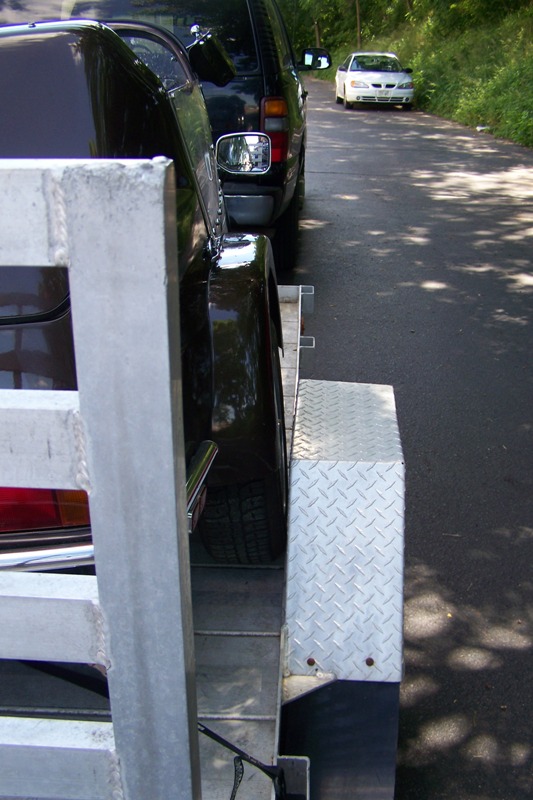

Here's my rig hauler.
9' X 6.5' (inside)
2"x2" tube frame
13" deck height
3/4" marine plywood deck
5' ramp gate
2' aluminum sides
Torsional suspension
15" modular wheels
Tool box
2 cycle chocks (right one is removable).
2,000# winch
Swing up tongue jack
Good access steps
Weight 550#
Posted : July 3, 2012 4:13 am
