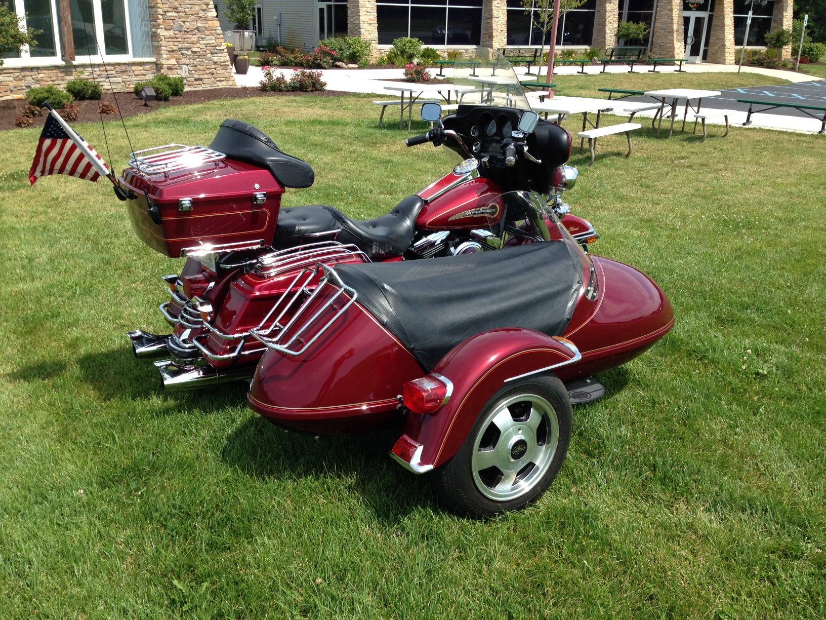

All right, it is a mark of shame to trailer any bike. It either means you aren't good enough to maintain and repair it yourself (shame!), you aren't man enough to ride it where you are going (shame! shame!), or you are a poser and the bike is a trailer queen (shame! shame! shame!)
Still (sigh) there are times when even the best of us are reduced to trailering their bike. And if that bike is part of a sidecar rig you do have a problem -- sidecar rigs are too wide for most trailers.
The last time Lady Carol was on a trailer was when I bought her. I had never operated a sidecar rig, and was, frankly, scared of piloting it several hundred miles without any experience. I had no friends with sidecar-operation experience available either, so I swallowed my pride and rented an open U-Haul trailer.
I solved the too-wide problem by separating the sidecar from the bike. Me being a Mechanical Engineer, I employed my considerable guesstimating skills to predict I could get everything to fit. This with only having photographs of the rig and a few key dimensions given me by the owner over the telephone. And it turned out good. I (just!) fit the two sub-assemblies into the trailer by dint of tipping the sidecar on its side (wheel down). Ratcheting straps and moving blankets kept things from banging around.
As solutions go, it wasn't so bad. I was able to get the halves on and off the trailer with a bit of help. And disassembly/reassembly of the rig wasn't so very hard either, again, with help.

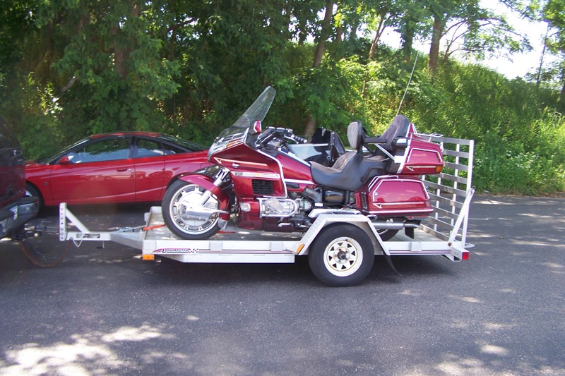

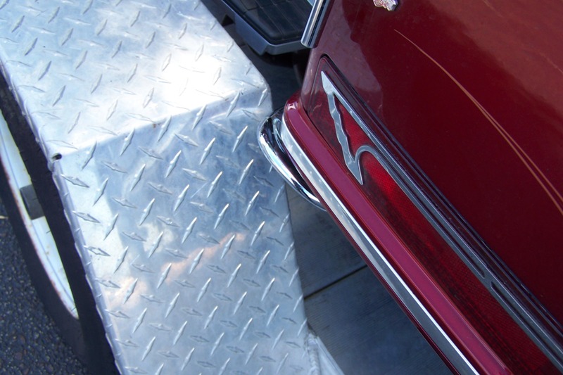

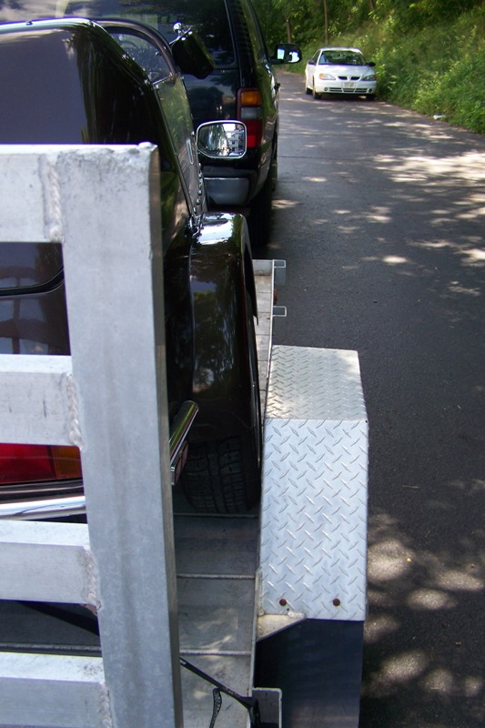

I don't like snowmobile trailers. They are much too tall to get the bike up there if it is disabled and often too tall if it's running. I went through about 5 or 6 trailers before I found one that I like.
The bed is 80 inches wide and 10 feet long. My Goldwing/Friendship 3 just barely fits, but I can even push it disabled onto the trailer by myself.
This particular trailer is a Loadmaster 8010AL Aluminum Lowboy.
