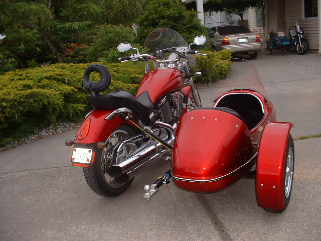

I believe Vlad was referring to the tongue of the trailer being to one side, not an inside rail hitch. I have made hitches for the sidecar that use the bikeside sidecar frame tube which pretty well centers the trailer.
Here's one that pulled a camper behind a Victory Vegas.
L.
Posted : August 15, 2011 4:38 pm

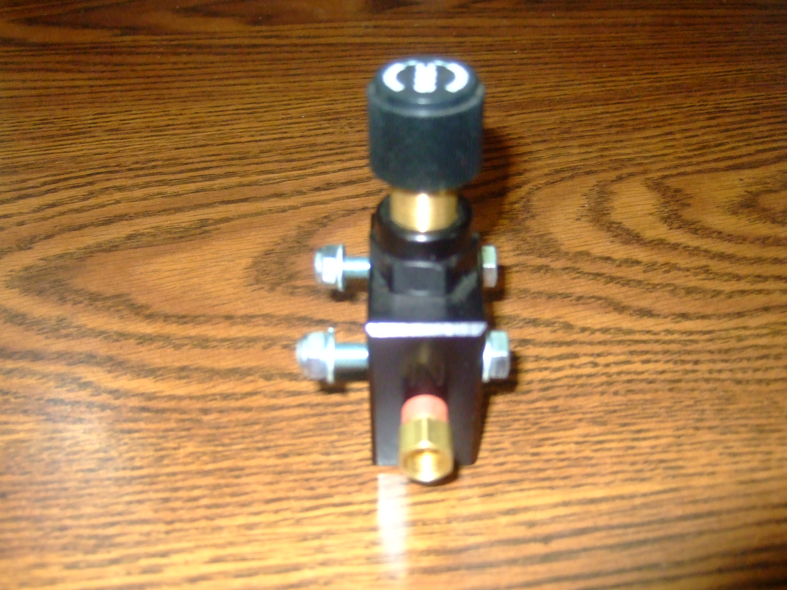

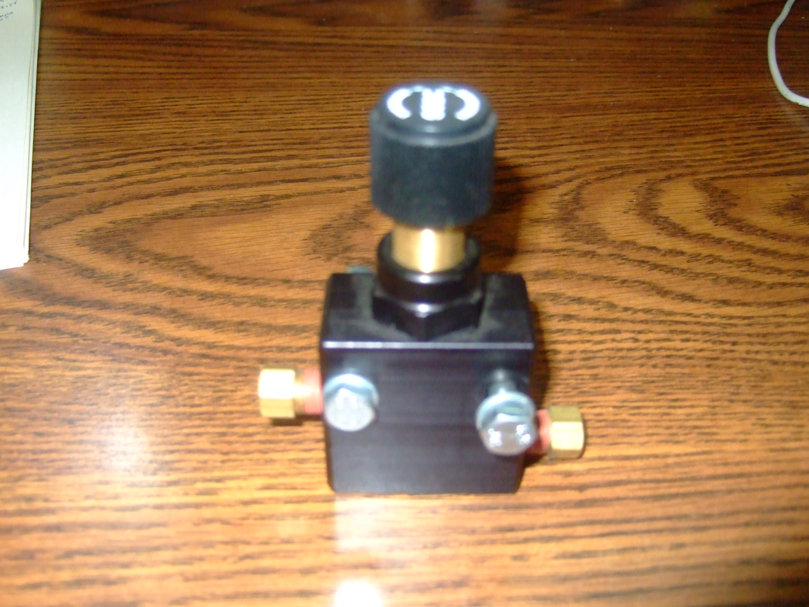

I have a new proportioning valve for sale. $50. plus$5.95 priority mailing.
As pictured.
Northwest Sidecars, LLC
208-629-8409
nwsidecar@aol.com
Posted : August 16, 2011 4:28 am
