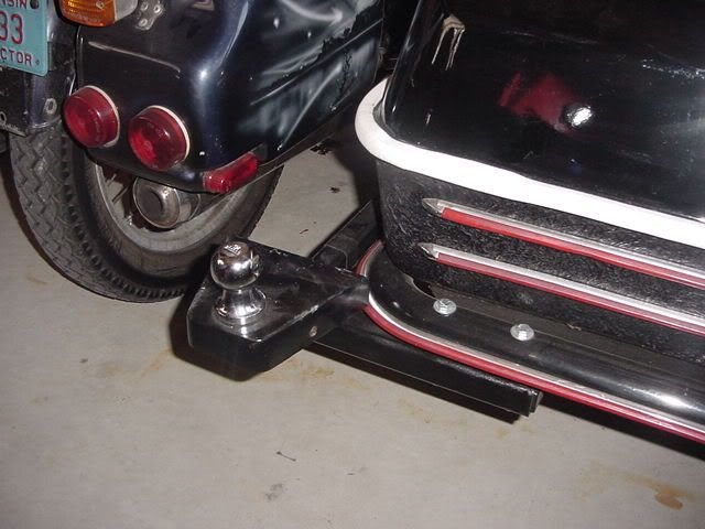

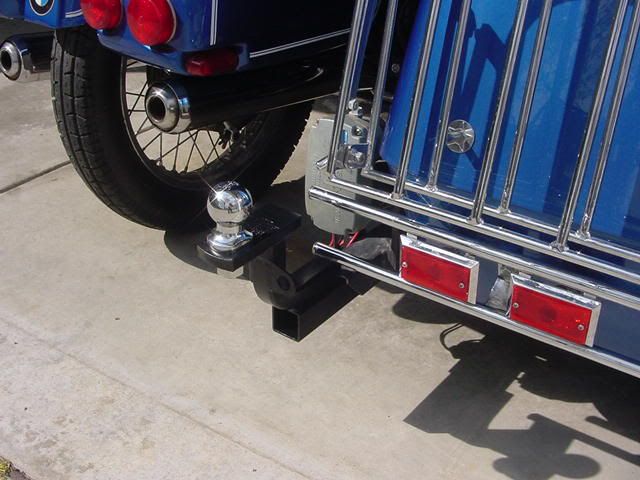

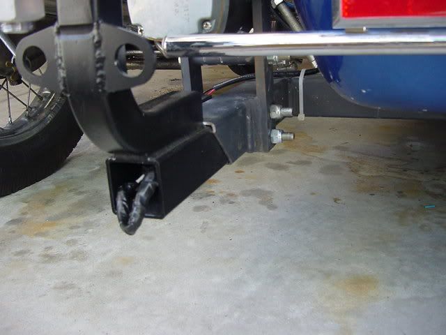

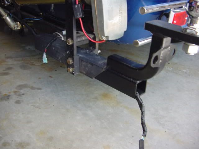

I made 2 hitches for 2 different SC's.
A terraplane and a Motorvation FII. both different approaches.
the MVFII is seen here..
the SC frame has a square 1 1/4 channel on back, perfect as a receptical. made a square steel insert to fit tight and added a store bought hitch the right height, to it. wiring with plug goes thru the hollow channels ...perfect! plug also stores awy in it.
the TP i made a long square channel like youy mentioned and bolted it to the SC front and rear frame pylons going to the bike. I also added a reinforcing member bolted to the rear bumper, which was strong 2" round steel tubing.
