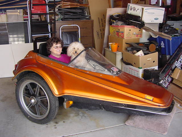

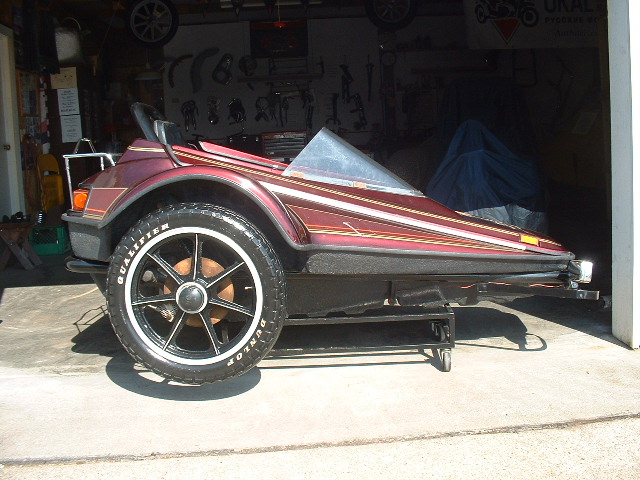

The earlier Vetter Terraplanes used a rather large wheel (as shown). These wheels are not easily available.
The vintage disc brake was not much force when new and may not be rebuildable.
If a trailer hub and wheel is used a 13" wheel with a P176/80-R13 tirewould fill the fender nicely.
The Studebaker Terraplanes built in Rosalia, WA in later years used the modular wheels and tubeless tires.
