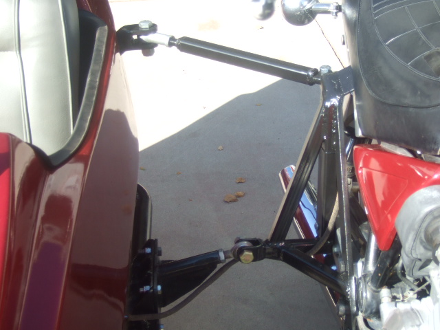

The Terraplane upper mount strut is basically a turnbuckle to adjust sidecar lean-out for tracking on crowned roads without dismounting.
An adjustable strut such as the one shown in the attached shot can be used instead.
