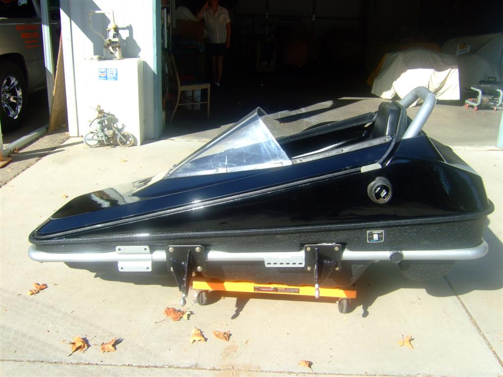

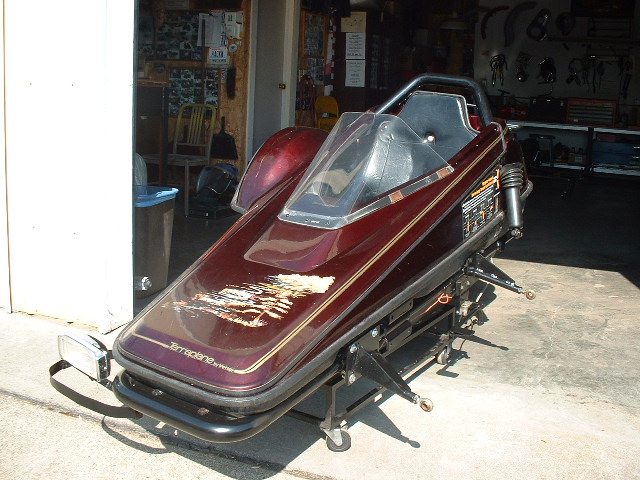

Here is a view of a Vetter car showing the trim grip mount which incorporates the hand operated screw jack for adjusting trim.
The other shot shows the mounting side that accomodates shorter framed bikes like Harley and an exrended mount pad for the Goldwings and other long lower frame bikes.
The bracket between the bike mounts (with a series of holes) is used for mounting their propriatory disc brake setup and compensating valve (if used).
L.
