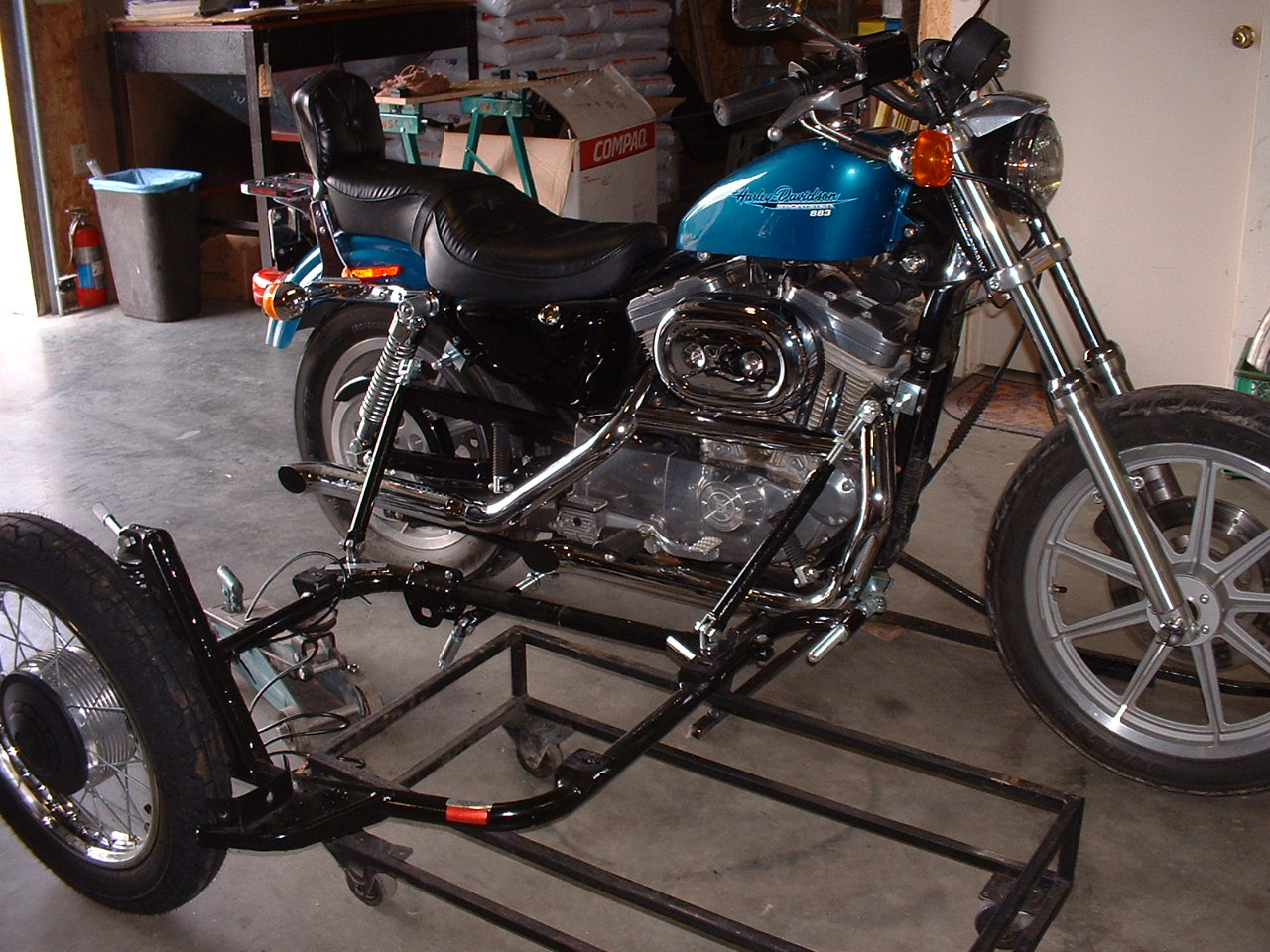

With no suspension it isn't a (stock) Velorex that you are working with. A stock Velorex 562 and 700 chassis looks like this photo. With coil over shock, swing-arm suspension.
The body floors can be drilled for mounting. Some may need large fender washers or plates to secure the body to the frame. Some kind of softener is also recommendedto keep from chafing wear on the body.
L.
