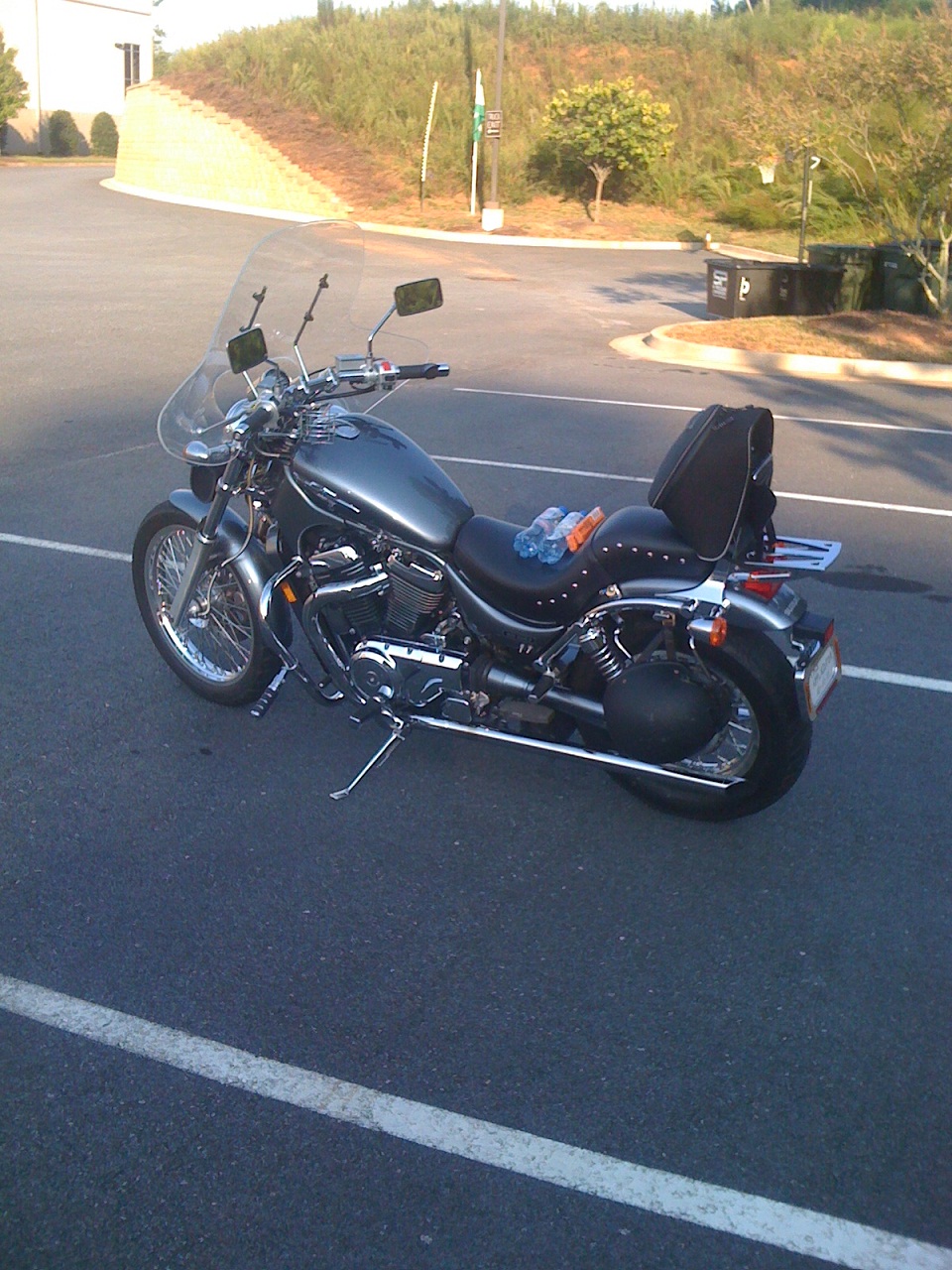

I just got a 2005 Suzuki S50 and noticed that in order to mount the universal mounts I would nee to remove parts to get to the frame. Has anyone mounted to a S50 and was it without a subframe? I will probably still proceed with disassembling.
