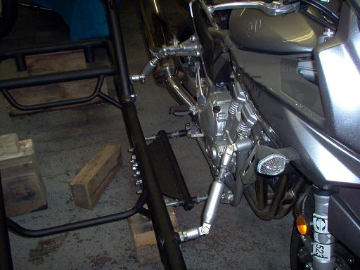

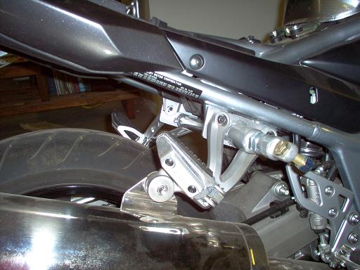

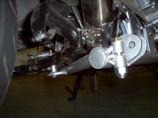

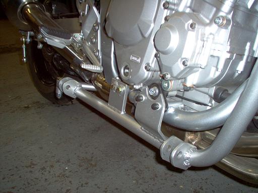

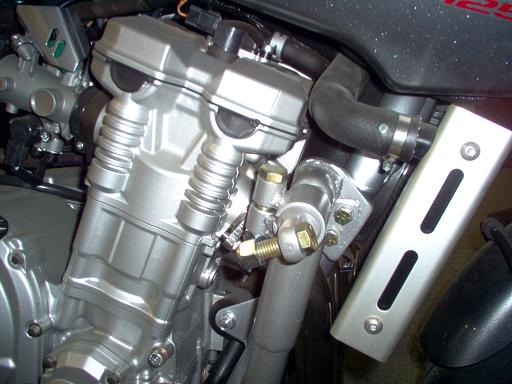

On the 3rd photo, 00647, what is the clamp holding in place?
Posted : October 1, 2012 4:12 pm
The pinchblock or clamp is part of the lower subframe around the front upper eye nut. The front upper uses the bike frame holes. The last pic. is a lateral support connected to the centerstand. I hope this helps you out.The Bandit makes a great tug.
Posted : October 2, 2012 11:10 am

After staring at the front upper mount pics long enough I figured that must be what you'd done. The lateral support for the lower rear looked like it might be tied into the centerstand, but I wasn't certain. Thanks for the explanations.
