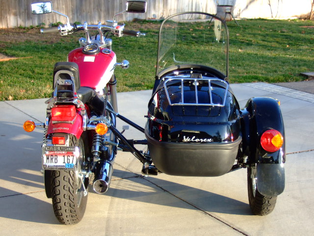

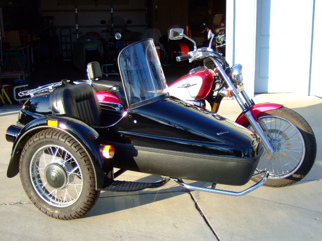

Here are pix of three Suzuki Savage LS650/C40 rigs we've set up. They make great rigs for other than Freeway driving.
1986 with a 562E Velorex, 2000 with 562 Cruiser and 2008 with a 563 Tour sidecar.

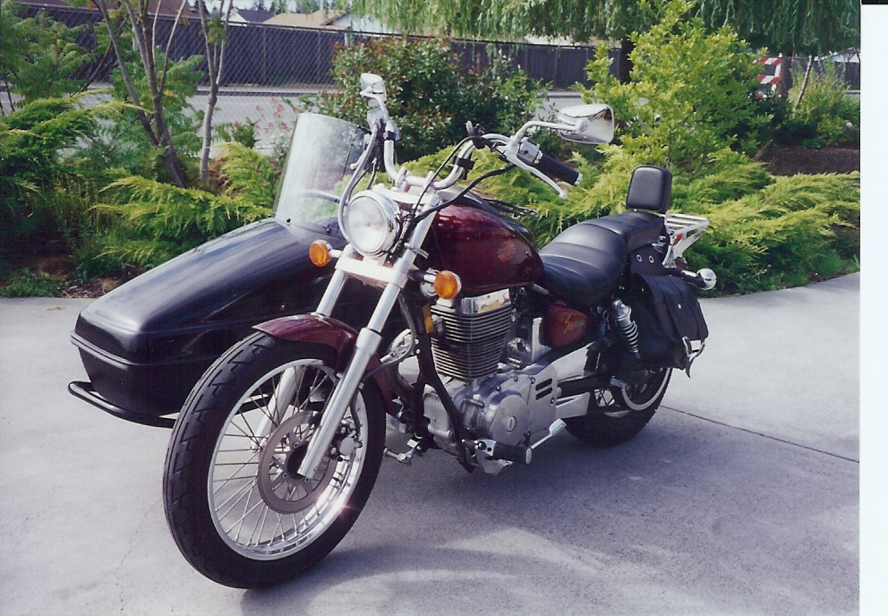

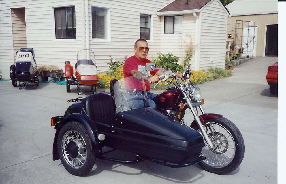

Okay you are talking about 650 s model single.
I put on a Velorex on an 07 model early in 07. It carried me and all my camping gear through Washington , Oregon, Idaho, and British Colombia for 35,000 miles over the next 3 years.
The first year I ran the stock belt drive for 15,000 miles, then went to chain. I think I remember it as a 15 X 50 ratio.
Fully loaded it could top Snoqualmie Pass without getting below 60 MPH.
I ran a Michlin 135 X 15 darkside tire on thew rear and an Avon sidecar special on the front.
I installed a VW steering damper. The machine handled beautifully with the installation of super bars and my own risers.
The bars were extended 1 and 1/2 inch on each end.
A harley Davidson buddy saddle from 1965 and later a sportster fron fender completed it.
The unit that supports the muffler was removed from the bike and a diagonal gusset welded in and a lug welded on.
The upper rear was using an enlarged hole as in the photo and threaded , then a thin lock nut inside the fender.
The two front lugs were welded to the frame as in the photo.
