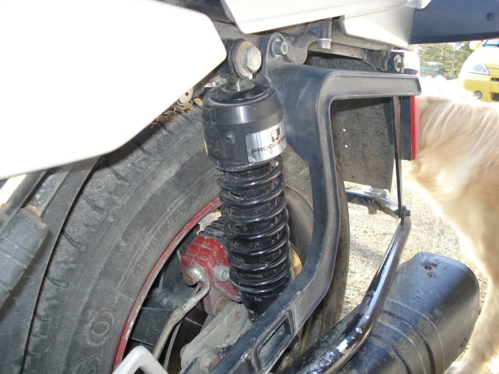

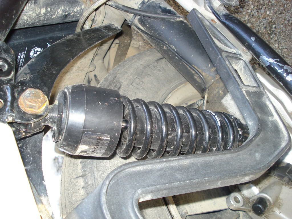

I just changed my leaking Koni (EML) rear shocks using Progressives. Mesured the eye-eye distance and ordered accordingly. Have not put many miles on them, but I expect/hope for good results.

No model number indicated. I will look later today for the box (which I probaly don't have). Early week, I will talk to 'my guy', and see if he can give me the info. He ordered them. On my K100, we got fooled. Measured the left hand shock, and then ordered two 12.5in (eye to eye) shocks. When we went to install, we realised the right one was shorter. It took a welded bracket to fix the problem.
Photobucket
Photobucket
Posted : March 13, 2010 1:28 am

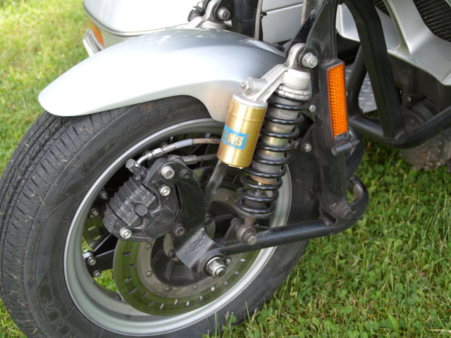

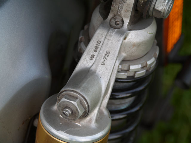

While at the SKUNKs rally a couple of weeks ago I saw these very nice Ohlins on a K75 rig. I've included a close up that shows the numbers.
