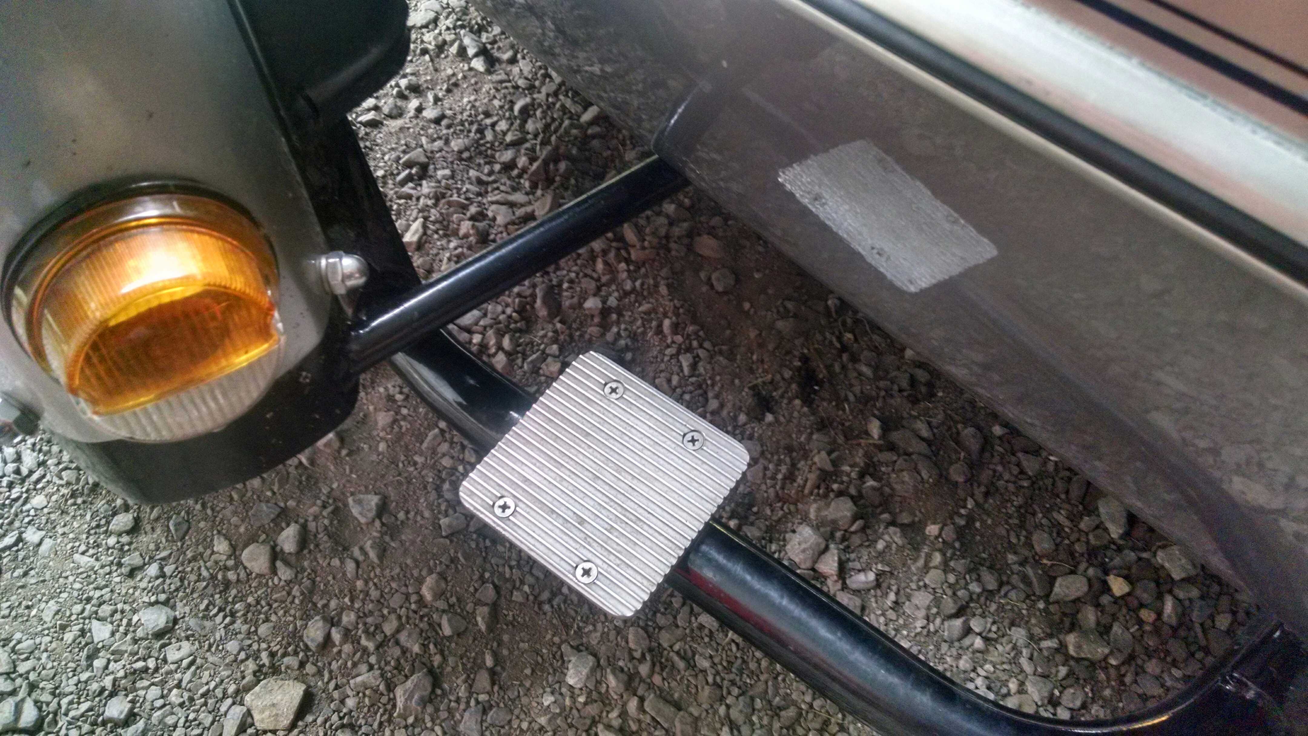

(@wvsporty)
Posts: 411
I have a small step on mine
Posted : August 13, 2015 2:41 am
(@wvsporty)
Posts: 411
I have a small step on mine , it is just a small plate and a u shaped bracket
Posted : August 13, 2015 2:46 am
(@mike-bodisch)
Posts: 237
WVSporty
Thinks for posting. I'm running an old/customized Velorex on my Yamaha V-Star and notice some folks have a problem getting in. This looks like an easy fix.
Mike in MS
Posted : August 30, 2015 3:35 pm

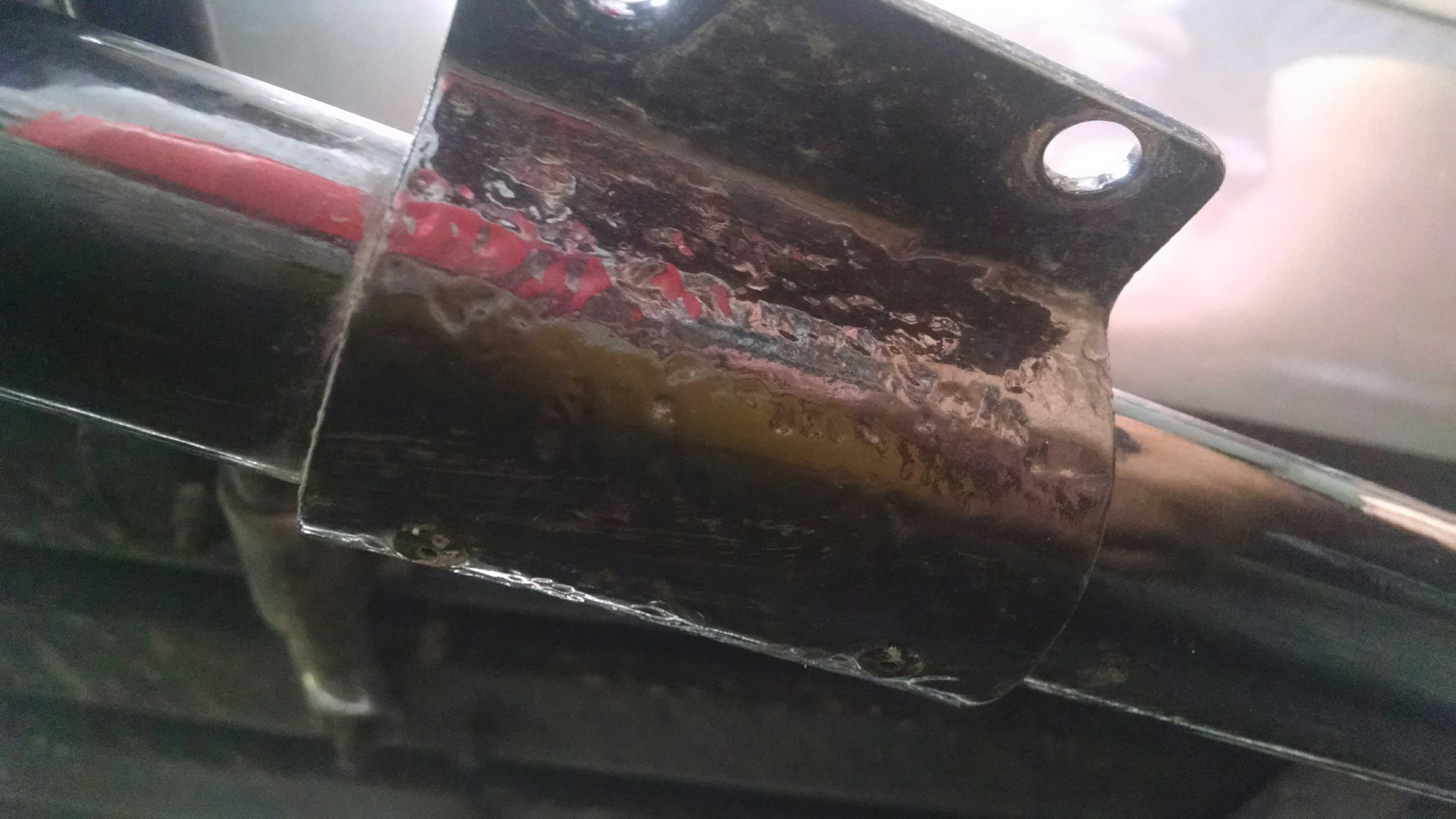

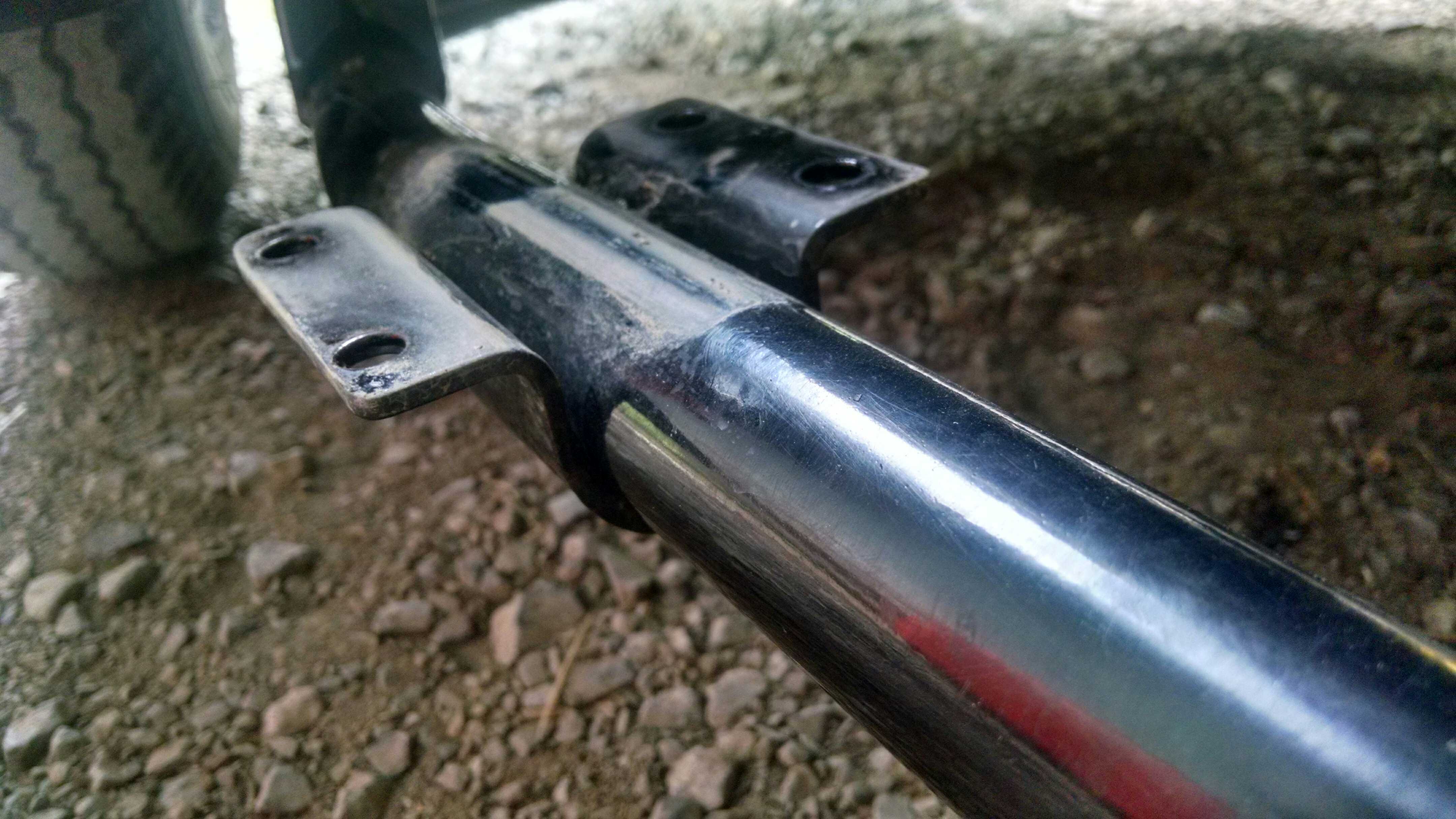

(@wvsporty)
Posts: 411
some close up pics. The lower bracket is actually riveted to the bottom of the tube to keep it from rolling.
Posted : October 15, 2015 9:46 am

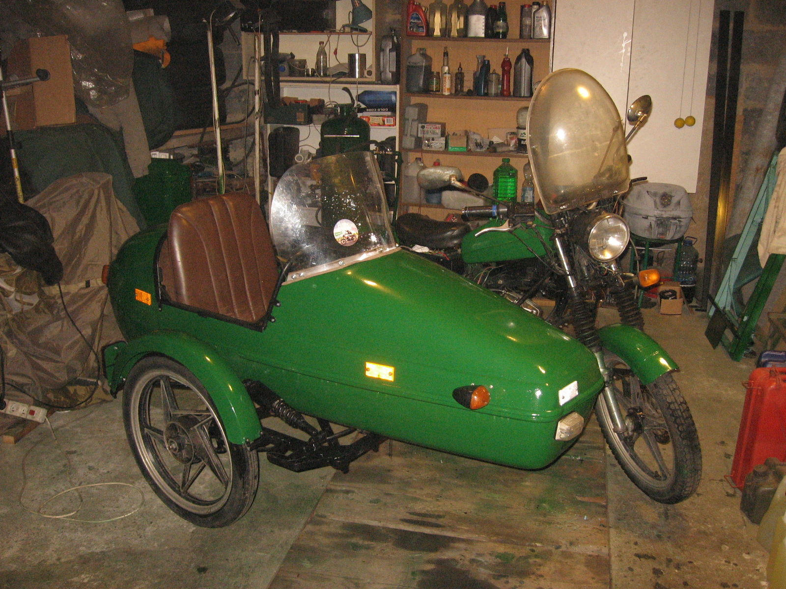

(@c64club)
Posts: 200
Recently I made a new frame for my Velorex, to replace my previous Ural-style frame that I bent accidentally by hitting a granite post with frame's step. I have built some strange step, that is rigid enough when you stay on it but will collapse when you hit something with it. It's made from 25xmm3 and 20x2mm flat bars, which are set vertically (step is 25mm high).
Posted : October 22, 2015 1:51 am
