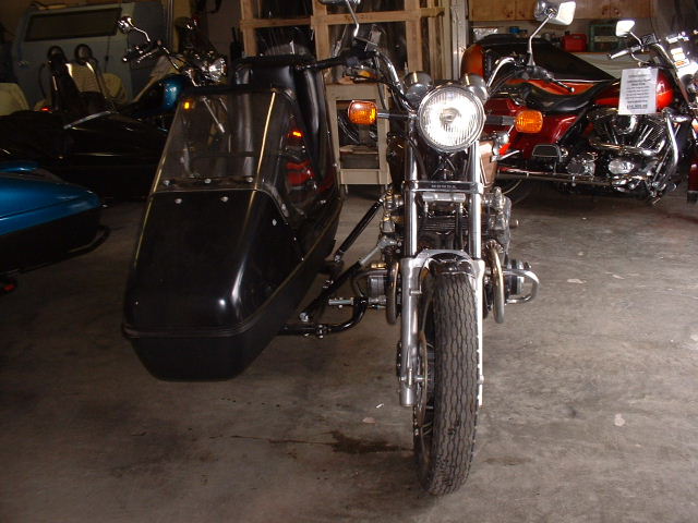

Hello,
1975 Honda CB750K + Velorex 562 rig.
Just installed brand-new progressive rear shocks about 1-1/4" longer than stock to reduce trail.
Very little low speed wobble and steering got noticeably lighter.
However now when I make a left turn I hear squeaky noise from somewhere around the front end. It sounds like brake disk squeak but it's not.
It happens in 5 MPH full lock turns and 50 MPH larger radius turns.
It is an old bike and I had only a few hundred miles on it since I attached the sidecar so something may be giving away..(?) but it started happening after I installed this new rear shocks.
Alignment was adjusted with similar length beaten up rear shocks I used for experiment. (1 deg lean out, 3/4" toe in)
What should I check?

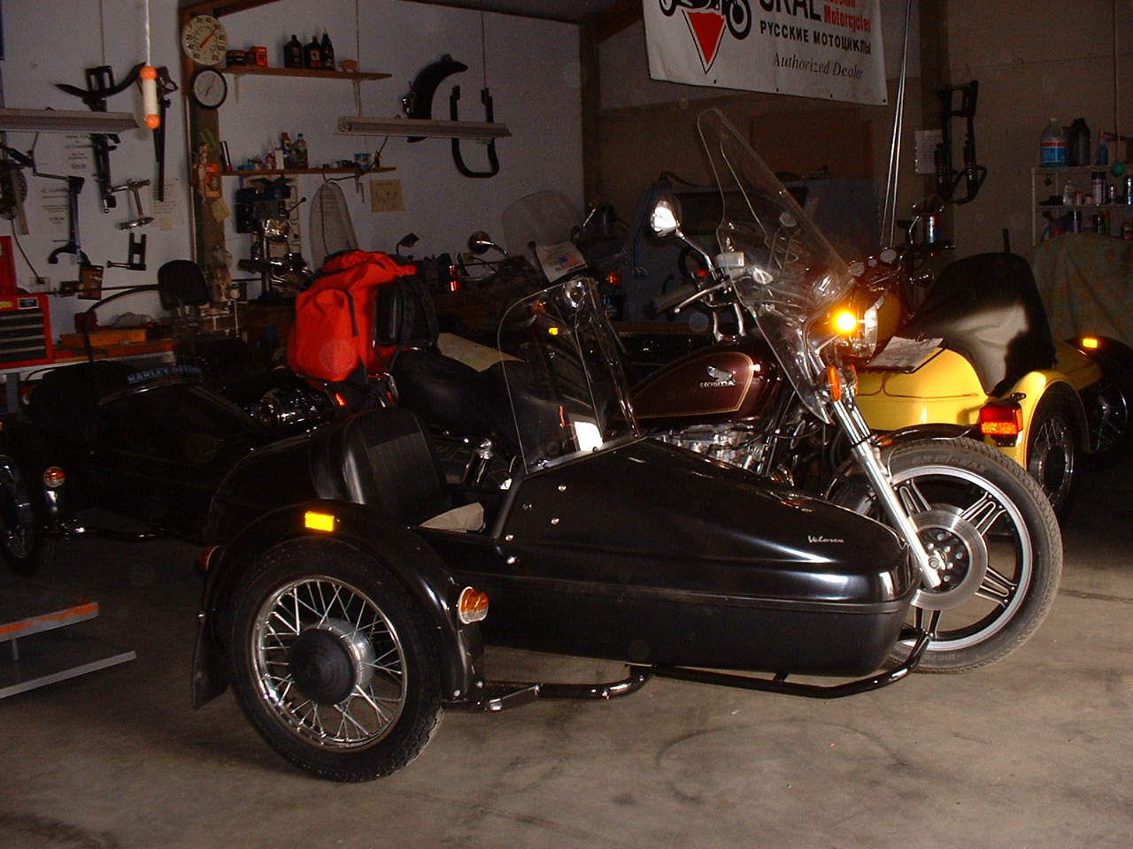

Mine does the same thing. I noticed that I needed to retighten the axle and also adjust the caliper spring loaded admustment screw. I was able to get rid of at least 90% of the squeak.
I had found after replacing front tire that my speedo drive was not snug, it could rotate some so I loosed the axle caps and snuged things up, redid the caliper adjustment and now it's ok. Might try that first.
BTW I have a 78 750k with V562.
