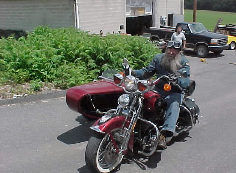

Hey Ditch we are located in central Pa. in a town called Penns Creek. If you ever jouney out this way give me a call. My number is in the link below. David ( Doc) who posts here sometimes is also near us In milheim. He has a Harley with a Motorvation Spyder on it and is a long time rider.
See attached for picture of doc

Hey Ditch, Doc here, I don't have toooo much trouble with my Motorvatin, I think it weighs alot less than an HD sidecar, I also have a camper I tow with this outfit, and I sure could use some more ooommph then, Iv'e thought of gearing it down but haven't made up my (?mind?) I'm gonna work on raking the front forks first, over the winter, guess I'm gonna send them to Liberty, I have a springer, later, Doc.
