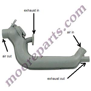

Old air cooled VWs used two of what they called a heater box. The exhaust from the cylinders towards the front of the car went through a tube to the muffler. The tube had an aluminum casting around it to transfer heat. The entire device was surrounded by a sheet metal box. The engine fan pushed air through the box cauing heat to be transfered and moved to the passenger compartment. A simple valve on the box controlled the heat/air flow into the car. Would look ugly but transfer a lot of heat. One of these boxes could cook the inside of a sidecar.

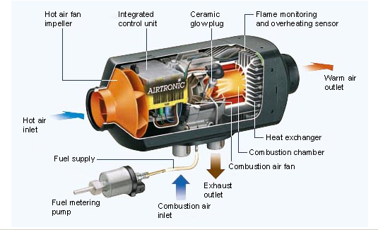

Great idea, the chrome shield could hide the entire length of copper tube. Add a small electric pump, heater core, and fan in the hack and you have instant heat. The beauty of it is that the exhaust gets hot almost instantly as opposed to the coolant in a water cooler engine. Great for my stone age Electra Glide, but if you're sporting a high tech BMW you need high-end technology. So for the tech-heads I propose a fuel powered heater. Some of these are mounted inside the cab of over the road trucks to keep the bunks warm while the operator is sleeping with the engine off. The heaters are small in size, very light weight, draw less than one amp, and consume as little as 1/4 liter/hour of diesel fuel. Probably over kill but it may be the ultimate accessory.

Here is a picture of the Beetle air box. The small lever on the upper left allowed a tin steel cable to move the lever and rotate a butterfly valve to restrict air flow

the wv thing looks to me like it will work. the thing that scares me is that in the event of a crack in the metal that will allow exhaust gas into the air supply and that could be bad. on airplanes the exhaust can be inspected every year for cracks. maybe i missed something but it doesn't look like the vw can be disembled to inspect. also the entire muffler is used to collect heat. its a fairly large area and it works quite well. it will put out more heat than you can use here in texas even at altitude its not all that hard to heat the bird. course it is traveling along at 150 mph too and the rig will not be that fast. also it doesnt' work at all sitting at a red light unless of course you put in a fan. johnny
