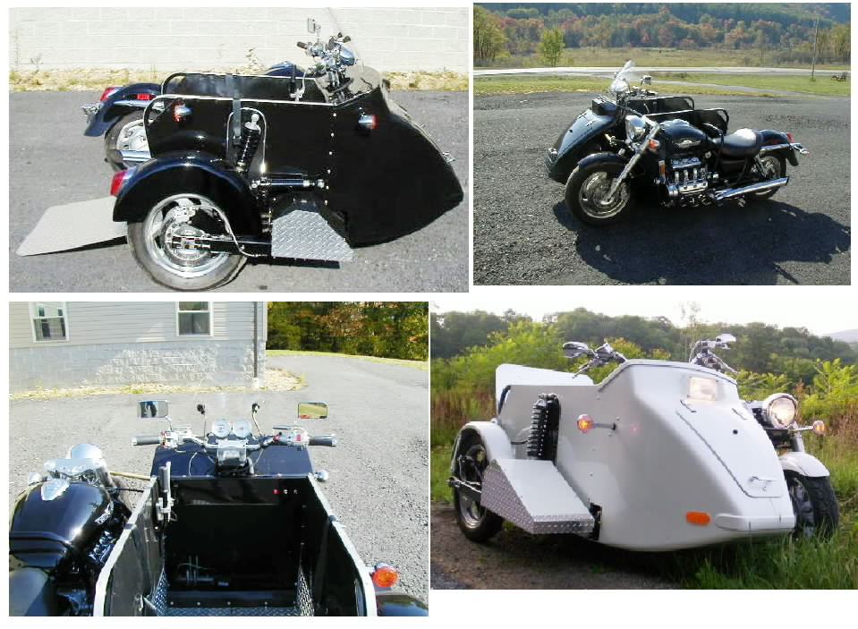

Google 'life motors' for some pics of what used to be TOMCO.
We have done wheelchair accesable sidecars but have not done one with the controls in the sidecar YET.
ONE THING TO CONSIDER WOULD BE TO DO A LEFT MOUNT SIDECAR IF YOU ARE GOING TO BE OPERATING THE RIG FROM THE SIDECAR.
You also may want to run quite a bit of wheel lead to add stability in turns away from the chair.
The first and third attached picture below is a custom sidecar we built for a wheelchair. '
The second one is taken from the Life Motors website and is the TOMCO design.

The second one is the one I was looking for but I still wonder about left turns and the bike rising.

We built the large one on the K1200LT. It has a splined end torsion bar suspension with shock and manual tilt adjustor. We do not use the rubber torsion bar trailer type setups.Some have used them but over time the sidecar setup begins to vary (toe in).
