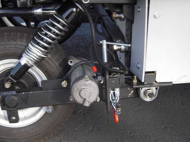

I tried it on my leaner rig and it somewhat worked. I used GL1100 starter motor and 2" OD butane rubber wheel from McMaster-Carr. My sidecar wheel is 8" trailer tire. I made crude mechanism to push the rubber wheel against the tire tread. GL starter had planetary reduction gears built in and that helped but the overall reduction ratio was not as high as I hoped for. For rigid rigs, sidecar wheel will be much larger so that will help. Engagement is per toggle clamp. I had to get off the bike to operate it. Not so convenient. I only tested it in a garage and never used in real life.
With better design, I think it will work.
